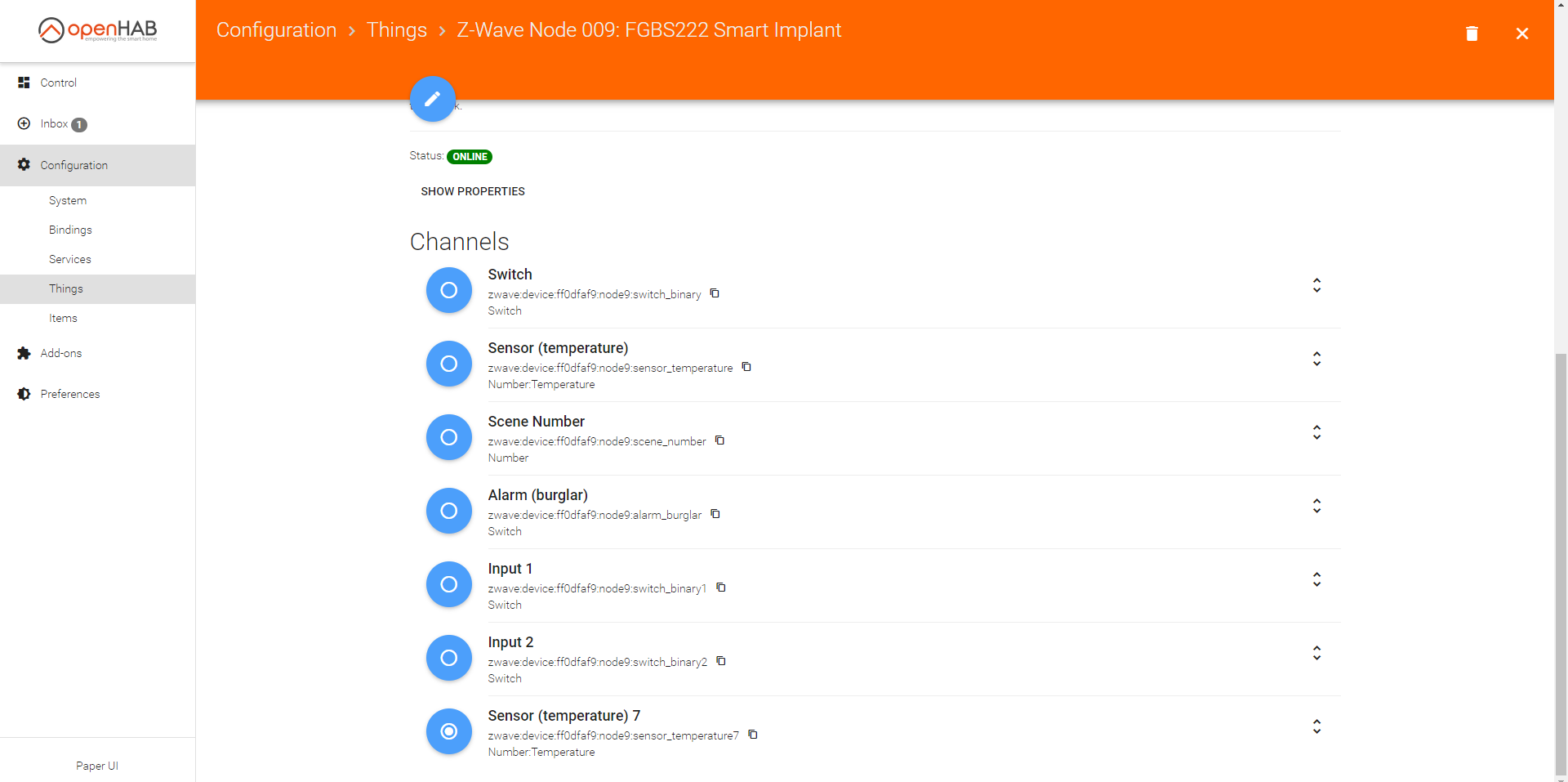

I have 1 sensor now, but I want to integrate 3 sensors, but when I connect both to the Smart Implant, it only recognizes one of them, even when I remove the Smart Implant and add it again. How can I get this value? Do I have to set the channel to “sensor_temperature8”?

First you need to have all sensors attached when you include the device in the network.
I find solder is the best way to make sure you have no bad connections.
Secondly that lovely piece of XML will need a manual edit as the binding does not support an endpoint with two channels on the sensor multilevel like this for some reason.

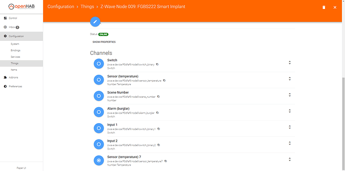

There is only displayed one channel for temperature, the “sensor (temperature)” doesn’t work. Where do I have to paste this xml snippet? Do I have to create a configuration file in the things-directory?
I am sorry to say that is the wrong template.
It is the old one prior to my edits and nothing will work with that template as it is wrong in almost every way. I think if you look back up to the top of the thread it was generated from a discovery but the device discovered had no external sensors attached.
Can you follow the link higher up the thread and install the template exported from the database.
You will end up with as many sensors as where attached when you included the device into your controller working and a load of other channels also

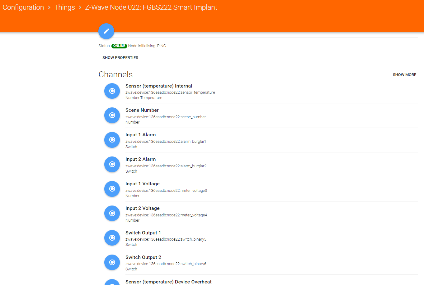

@robmac I tested this yesterday (with your new template) and the device doesnt seem to respond after inclusion.

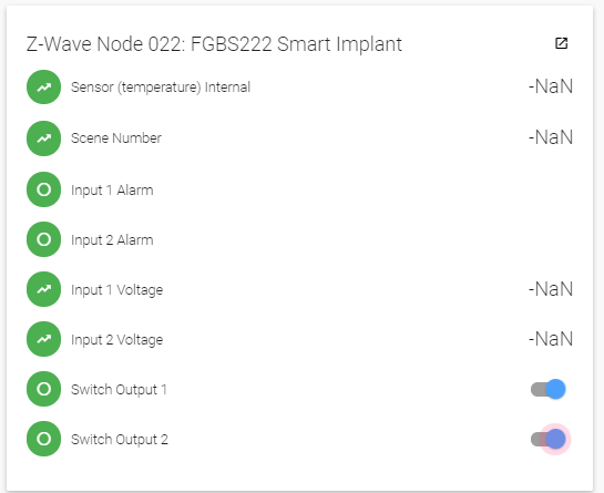

I am primarily using this as a remote switch, though toggling Switch #1 and #2 dont seem to do anything. If I change the configuration for the device to be “Normally Closed” then physically reset the device all of a sudden the Outputs make contact.
The device also does not seem to report other parameters.
Please see attachments, I detached the humidity and temp sensors as I am not using them. my FGBS222 is node #22

Ignore me, I made a stupid wiring mistake :-/ The switches are now working for me :slight_smile:
