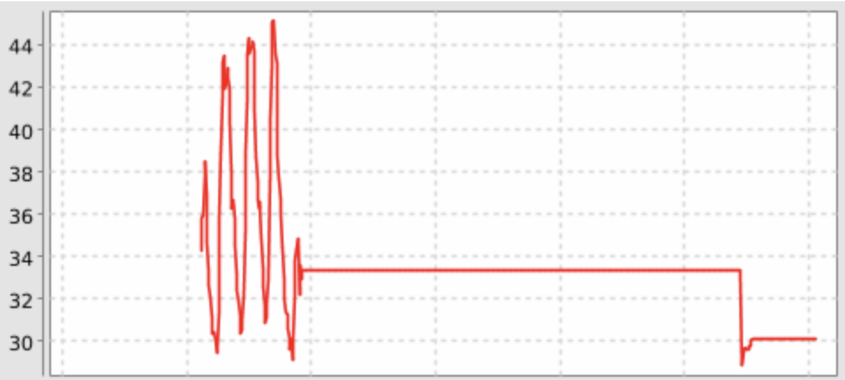

I am using DS18B20 sensors and openhab 2.4. Maybe this graph of the temperature can better describe my problem:
You need to use the Sensor (temperature) X channels. I’m not sure these are available in 2.4. I recommend to upgrade your zwave binding to 2.5 snapshot.
Ok, I tried this before, but it didn’t work. I uninstalled the “normal” binding in the paper ui and followed the steps to use the 2.3 snapshot, but then I hadn’t any zwave binding. How can I choose the other channel? There is only displayed one Sensor (temperature) x like shown in this photo:
Correct.
Please use 2.5 snapshot.
Also make sure you delete the item and readd it for the new channels to be updated.
Regards S
Oh, sorry, I meant version 2.5. I will try to update it again, but is it possible that only one Sensor(temperature) x channel appears and does not work properly when the zwave snapshot isn’t the latest? I thought that no channel would appear?
It depends on when the channels were added.
Please read the whole story in this thread :grinning:
