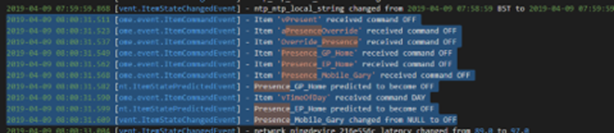

Not sure if this is a rule / item issue or an owntracks one but hereās my issue:
Iāve set up some items and rules as per this example, modified them slightly to include a second person, but all still in the gPresent group.
Both my and my wife have owntracks on mobile and both have a region set to home, which when there is movement in or out of a region passes back on or off to my dummy item, (Presence_GP/EP_Home in the image below), so that it triggers the ruleā¦everything perfect here, the logs show the logic working, and vPresent is set to off, (ie no one home), only if both of us are outā¦SUPERBā¦
Now for the issue,
Every morning I wake up and check the presence items, (Iām testing it for a while to make sure itās rock solid before I apply logic to the home / away state), and it seems that sometime every night all the variables are setting themselves back to OFF for no logical reason - that I can see anyway!
Two instances from the logs.
Different times, but same resultā¦itās almost like the system is deciding to dump the variables and turn everything off.
The problem is that I now have to spend a day going in and out of region on OneTracks to reset them all properly so itās up to dateā¦do that and then sometime during the night Iām back to square oneā¦
Any ideas anyone?
In the future please post logs as text using code feces instead of screen shots. Screen shots are impossible to read from a phone, cannot be found in a search, and cannot be copied from.
There is nothing on OH core that will turn off the Switches so the changes must be coming either from your phones or from OwnTracks. Given thatās the case, it would bet better to post this as itās own thread where users of OwnTracks will see it and hopefully be able to help.
Finally, put the Switches on your sitemap and in the morning just to them manually. You donāt have to drive around to cheer the state of an Item.
