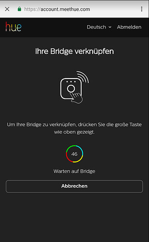

when I try to start the devicescan from google assistant on my pixel
it looks like this:
Is it a difference to use Assistant vs. Home?
it looks like this
So does it actually work or does it run in a timeout?
There might be - you are redirected to account.meethue.com, which looks as if this tries to do a Cloud-Integration. In my video you might see that the redirect goes to hue-adapter.appspot.com, which is not hosted by Philips, but probably just holds the code to do local discovery through UPnP.

I’m running in a timeout.
It starts at hue-adapter.appspot.com, too - but from there I’m redirected to the account.meethue-Site.

So I got my old Nexus 5X running with Android N and Google Assistant. I can confirm it took me to the same meethue based signup and couldn’t find my Hue. So I’m back to wondering if it’s a regional issue as to which authorization site you end up at and if you can do it locally or not.

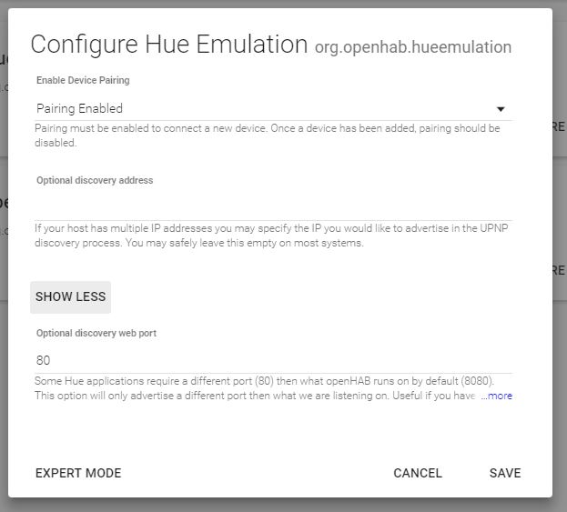

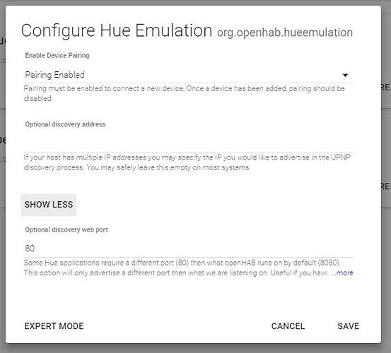

I’m in the US and have no problem running discovery so long as I have forwarded TCP port 80 to port 8080 on the primary (only physical) network interface of my RPI3.
Obvious things to check:
  • pairing enabled for the hueemulation addon
  • optional discovery web port set to 80
  • firewall blocking neither TCP port 80 nor TCP port 8080
Forgive me if those are painfully obvious, but I have been known to overlook the painfully obvious in the past.

Thanks @scottk I have all those setup the same. Do you also end up at the meethue site for registering the hub?
@rgerrans,
When I had GH run discovery, it did not connect to the meethue site, rather it connected to hue-adapter.appspot.com, which I guess is available via mDNS.
I wonder what’s going on the backend that some of us are getting sent to the hue-adapter.appspot.com and then redirected to meethue while others stay on the appspot.com. This seems to be the common thread between who can connect and who can’t.
