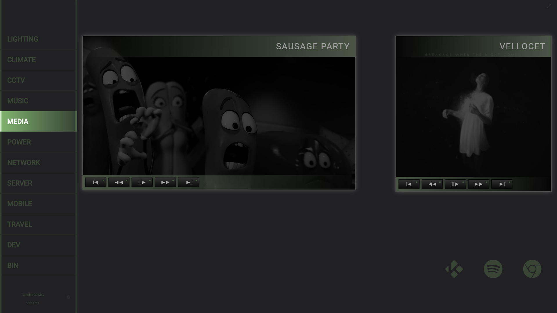

Yeah it’d be nice if you could share some of the other widgest as well, i.e. Kodi, the log text box, etc.

Kodi binding is broke for me since updating to 2.4.0. soon as that’s fixed I can test and finish the Kodi remote.

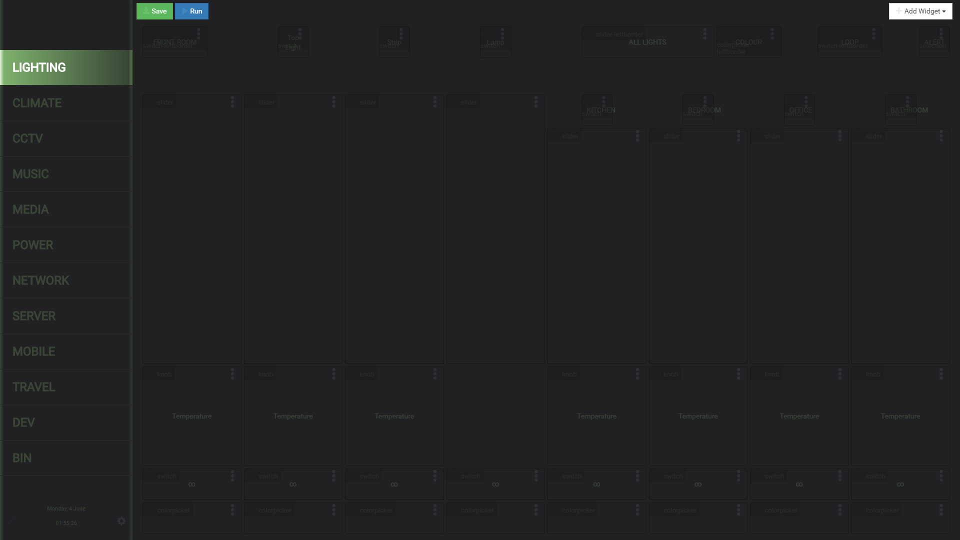

I can do that but it means merging the code with your own in “/habpanel/index.html#/settings/localconfig”
It might be cleaner for you to just set those up from scratch yourself for only what you need, as my lighting screen is so full with stuff, that it only fits on a PC screen, if you load that up on a tablet without changing display scaling options, it won’t fit unfortunately.
They are standard sliders, knobs, switches and colour pickers, using my css override, they should look for you, how they do on my screenshots.
Here’s how it looks behind the scenes:

You can download the generic media widget here:
