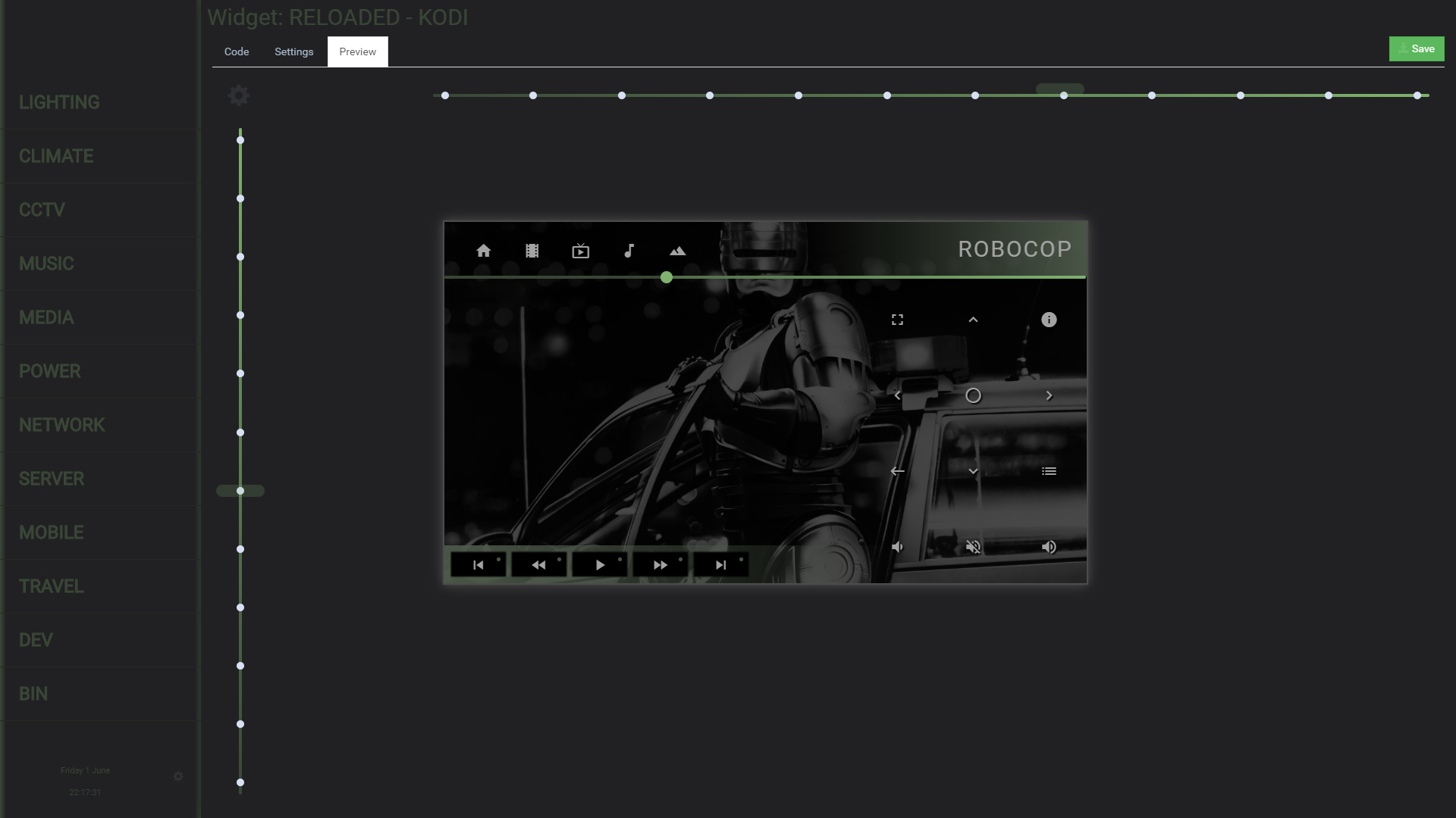

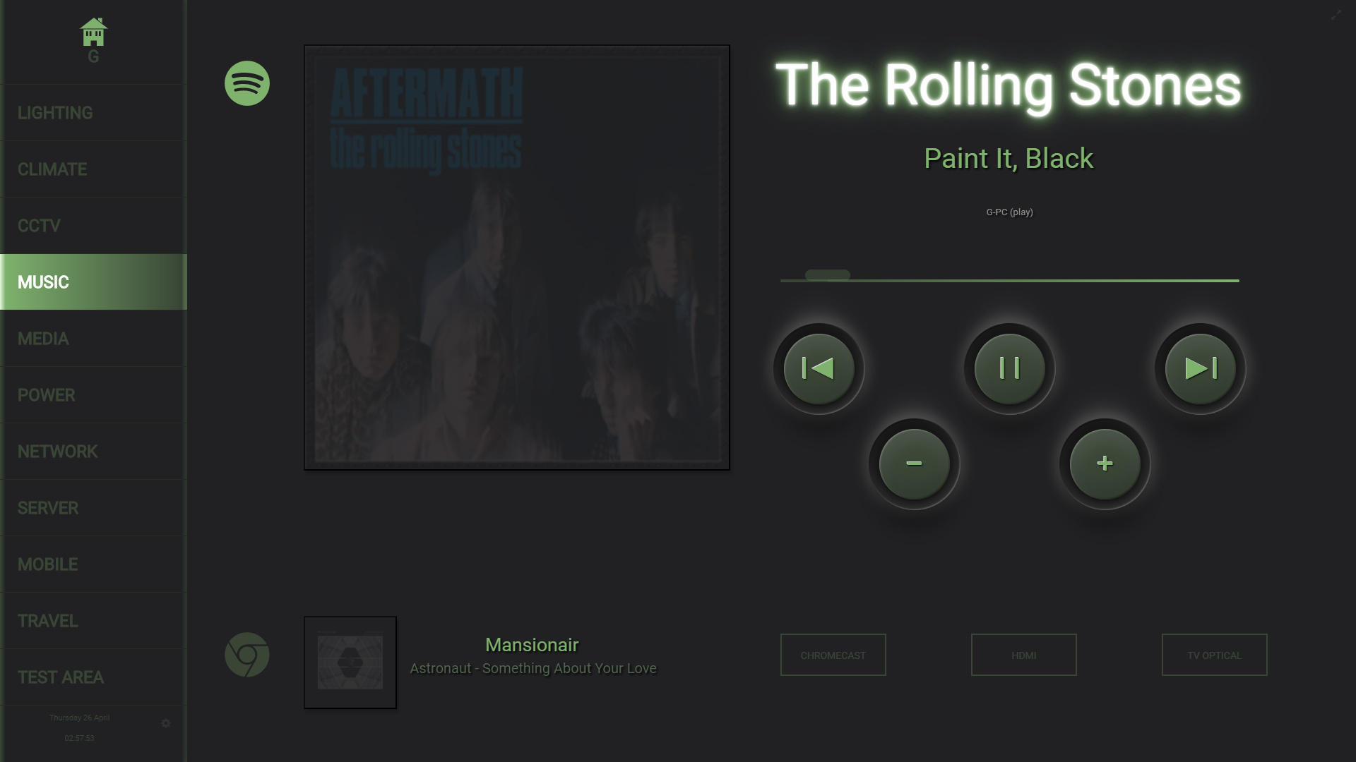

Generic Media Control Widget:
Widgets for the MUSIC screen:
RELOADED - MUSIC - Now Playing Cover.widget.json (281 Bytes)
RELOADED - MUSIC - Artist Title Device.widget.json (379 Bytes)
RELOADED - MUSIC - Play Button.widget.json (736 Bytes)
RELOADED - MUSIC - Next Button.widget.json (175 Bytes)
RELOADED - MUSIC - Previous Button.widget.json (183 Bytes)
Last updated: 3rd May 2018

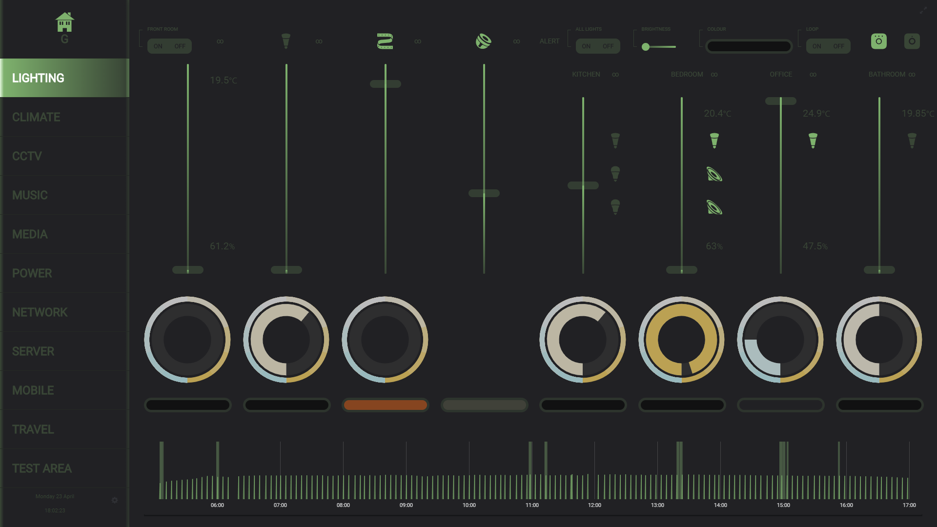

Colour Temperature dials
To get your colour temperature dials like mine, you have to do the following:
Set knob to Tron skin, and enable ranges, then set the following hex for each.
0-10 = #cbfbff
10-20 = #d4fcfe
20-30 = #e7ffff
30-40 = #f7ffff
40-50 = #ffffff
50-60 = #fff9e6
60-70 = #fff7da
70-80 = #fee9a6
80-90 = #ffe083
90-100 =#fed967

I like the way you display the Grafana graph and wish to use your MUSIC part exactly you have done it.
Also the other parts like lighting will be a very good start to get a smart idea how to get things done.
The elements making up the music player are all single template widgets. I could show examples in the thread, I don’t know any other way to share the widgets, or how to make them in to downloadable widgets.

i got a few questions:
what kind of colorpicker are you using at the first screenshot?
are the icons of the hue lamps switches?
do you use the dimmer for a group of lamps or one for each lamp?
yours alex

@e36Alex
I’m using the standard modal picker colour changer below the colour temperature knobs, which are just standard knobs with the tron skin setting applied.
I’m using dimmers for both single lamps and some groups too. In the room the panel is in, it will have a dimmer for each bulb, while other rooms are set as groups.

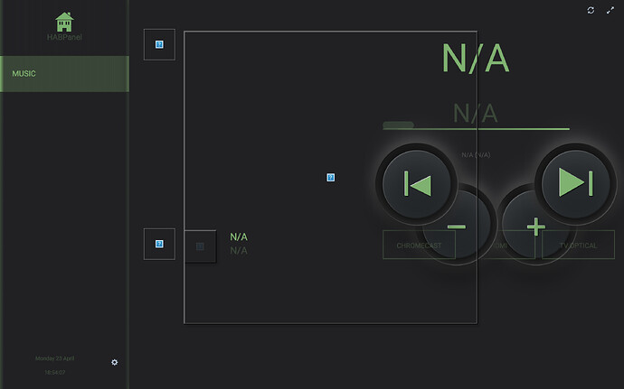

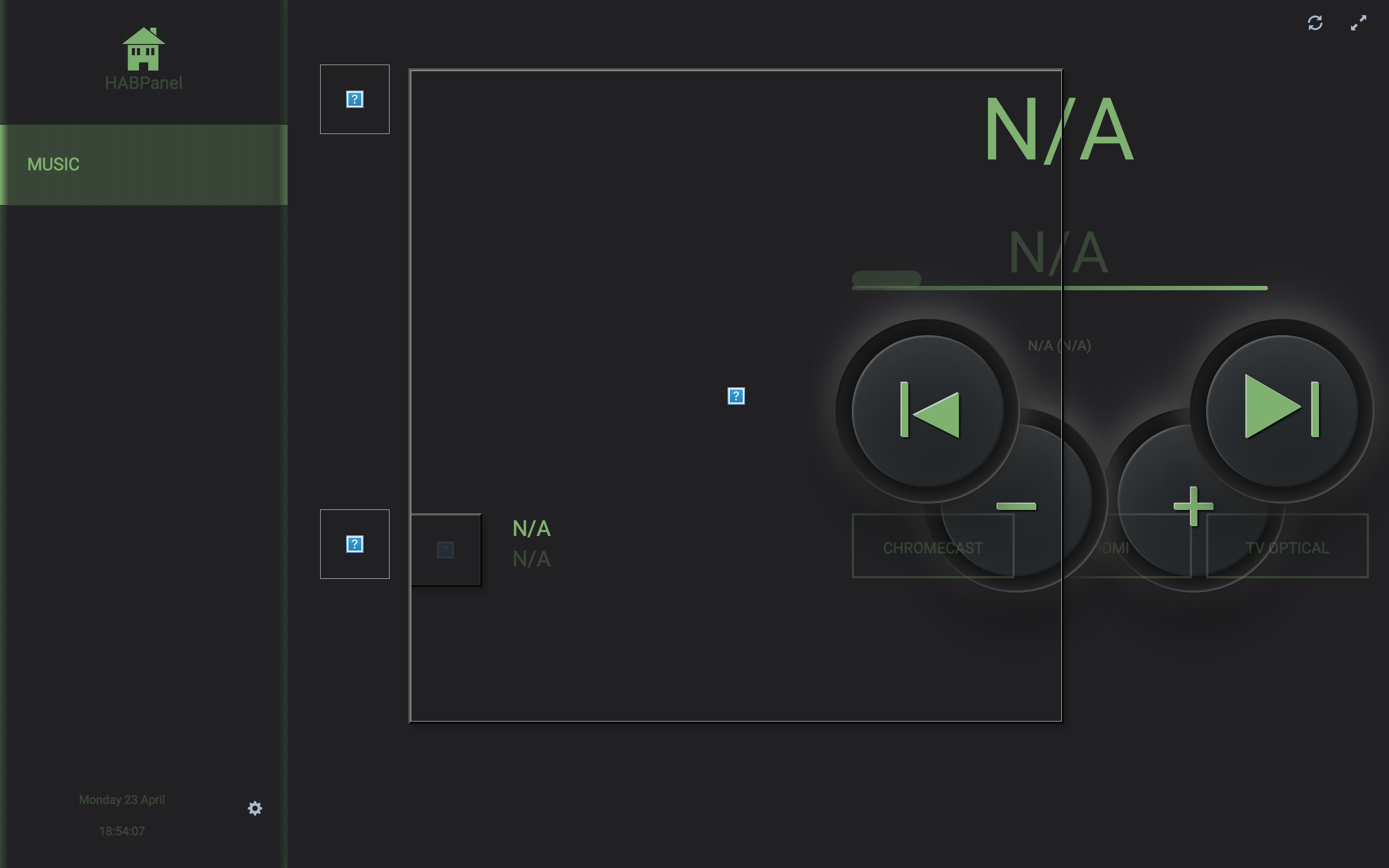

Without changing anything it looks like this:
The way I have it set is really only going to work on 1920x1080, so you’ll need to remove, or move about elements for smaller panels.
Broken images are there because they’re currently set to Spotify and Chromecast Audio items for my own setup.
You can replace these with your own items for image art from Spotify, or whichever your player is. Then modify the following areas in the template widgets.
{{itemValue('spotify_current_cover')}}
You’ll need persistence setup too, so it won’t show broken images and N/A when your music player isn’t active.
