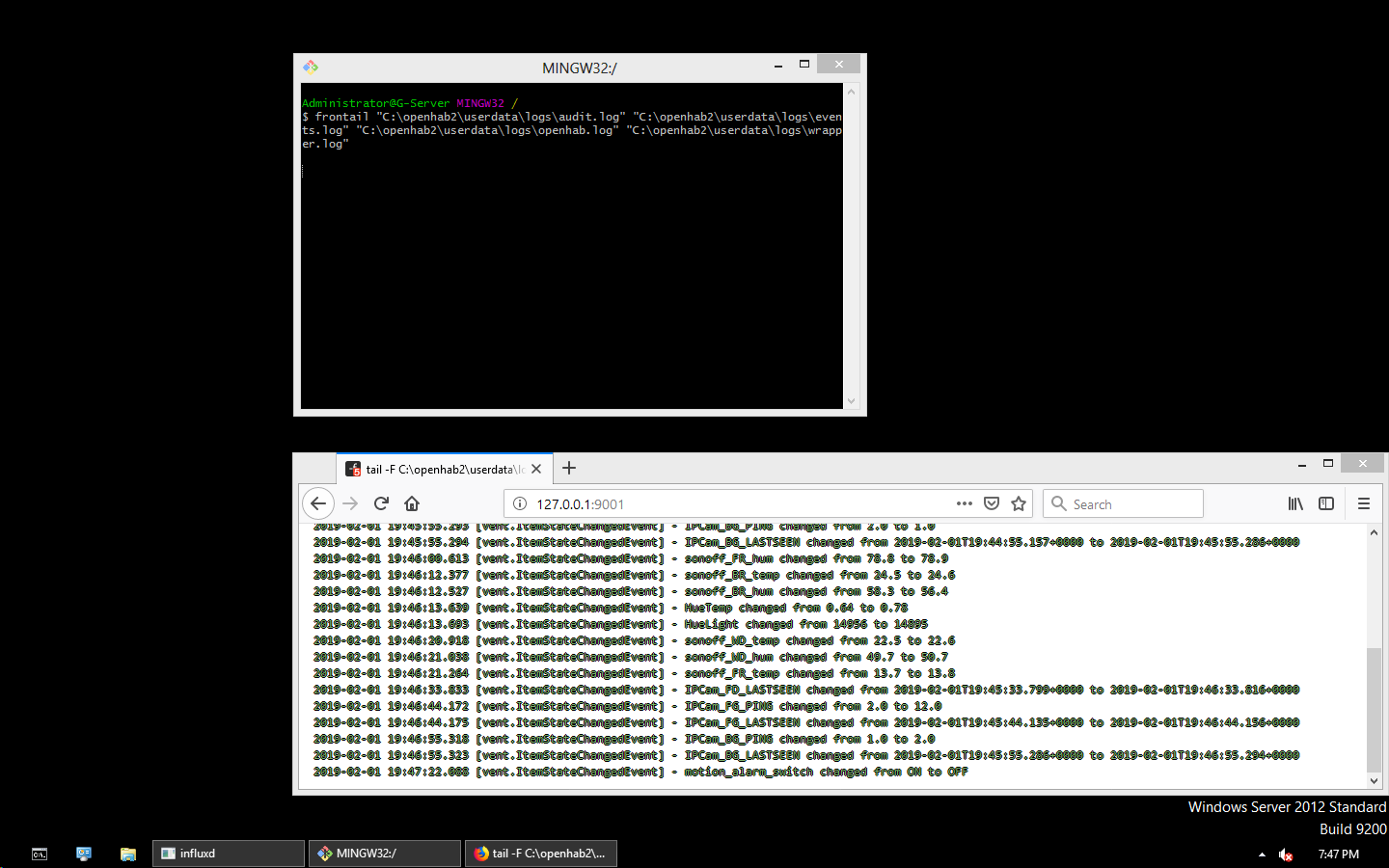

Here is frontail working on my Windows box:

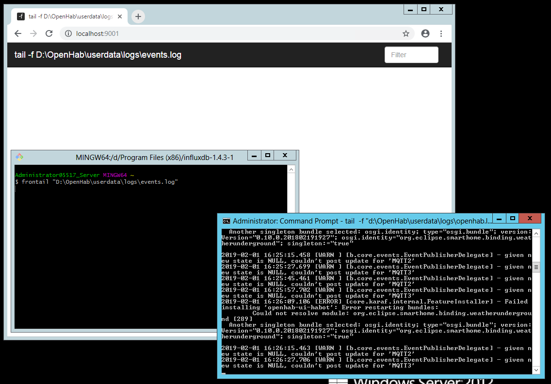

@gman you have spurred me on to find a solution for this!
In going back and reading the issue it seems that Windows does not have the TAIL command available, but I was able to find that Microsoft made it available in a resource pack. So I installed the resource pack and added the path to Windows.
Now I can get tail to run and scroll the log, just not in the browser…does this trigger any bells? I have frontail installed but it shows an empty page…see below:
Have you tried a different browser? Maybe on another machine. I can’t remember having that issue myself. Does the page source code yield any clues?
As I remember, just using the gitforwindows was enough to get tail working, as that’s one of the things it does. It seems like you’re running it from the influxdb folder? Not sure if that makes a difference.
