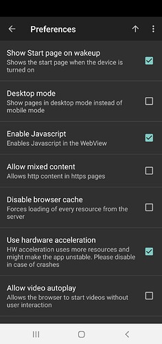

What preference do I have to enable? You didn’t mention I have to enable something first.
See above. It is in the Browser category.
I’m sorry, It seems I’ve overlooked that. I reinstalled the new version, but I can’t find the mentioned option in the browser section.
It should be the second entry, “Pause webview..”. But most likely it is not going to work with dimming. Wait until I have checked that. I will most likely update the APK later today to support dimming.
I am facing also problems with unresponsiveness long time now. I have try the new build but also I don’t see this option pause website.
Sorry guys. Not sure how i did this, but it looks like the apk was generated in the wrong branch. I have now updated the apk again and made the preference work when dimming. You can download it from the same URL.
