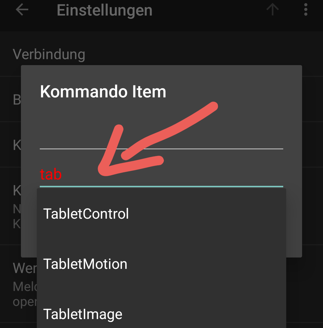

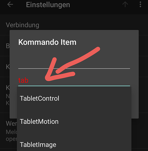

Please make sure you’re typing into the lower field, then auto-completion should work (assuming the server is configured properly):
Thanks, it works now! :slight_smile:
