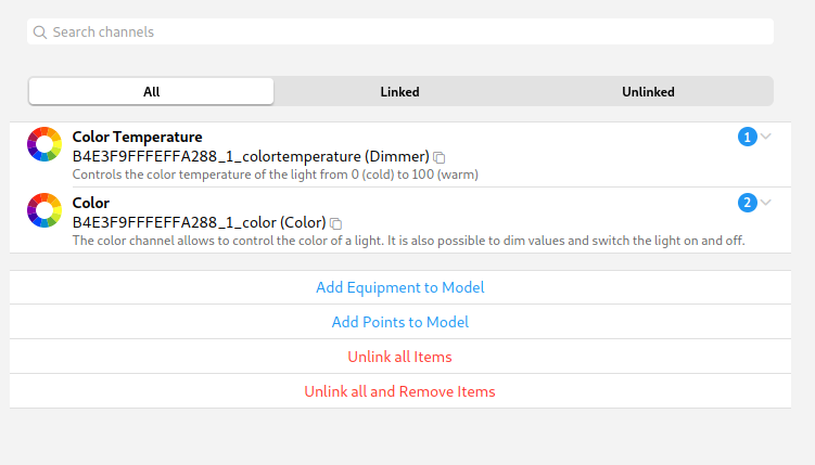

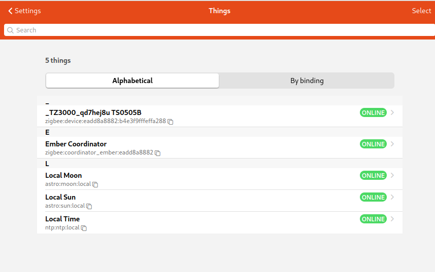

  • Installed and configured socat and pointed it at the Lidl gateway
  • added in the zigbee binding
  • added and configured the Ember coordinator
  • added thing, select zigbee, pressed scan, which found the bulb
  • clicked on channels, and there were 2 :slight_smile:
  • added to model,
and it works.

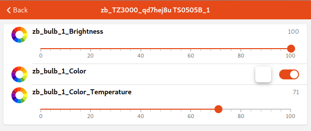

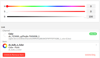

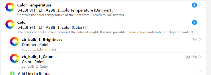

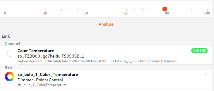

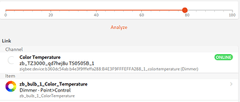

  1. The paring works and I get 2 channels and 2 items.

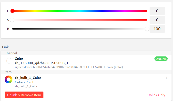

The color control has Hue, Saturation and Brightness
The Color Temperature Dimmer which maps to the actual 153 - 500 range for the bulb.
However its not possible to change the brightness in white mode, in RGB mode its fine.

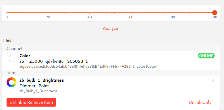

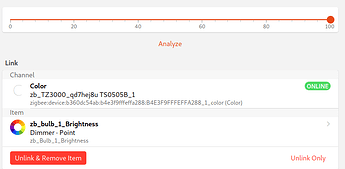

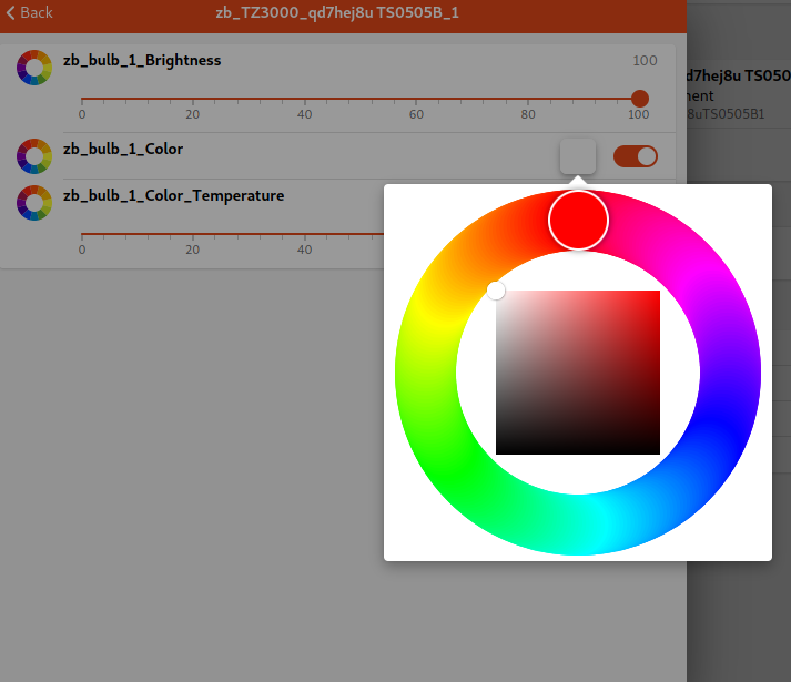

My hack was to add a dimmer item to the color channel …
Call it Brightness
And end up with this …
Click on Brightness will turn on white at the selected brightness.
Click on Color Temperature will set the color, but only if light is on
Click the switch on/off will turn on bulb to last setting.
Click on the color square will bring up the color wheel
The Hue is changed by the outer color wheel, the saturation and brightness are changed in the square.
Please let me know if there is a better or cleaner way to do this.

This is not a hack - openHAB allows you to set different channel types - so a color channel accepts an OnOff, Dimmer, and HSB.
I don’t see any way to improve this without having a dedicated colour temperature control and type.

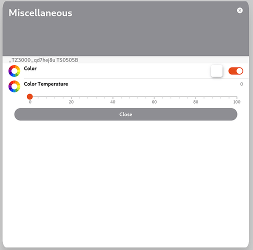

I have the same bulb here and it only reports its color channel (RGB). In a 3.2.0 install, is there a way to force it to report its color temperature channel so that I can control the “white” one as well?
You would need to use the 3.3 snapshot. I’m not 100% sure if it will work as I know there are some breaking changes in the core that might impact the ability to run newer bindings on older cores.
How is the bulb working for you guys? I realized I also bought lidl rgb led some time ago (specifically TS0505A - E14 candle), at that time the color channed did not work so I forgot about it but after reading this thread I paired it again, set XY color commands and it works fine. My only problem is that I can’t get solid red color from it, setting hue to min/max gives me sort of orange-ish color. I also have zigbee rgb strip so I put them together into same group (btw openhab doesn’t seem to have UI group for color for some reason…), but the colors on the bulb seems to be ever so slightly off (rgb strip is pure red, bulb is sort of orange, if I set the strip to orange-yellow the bulb is slightly more green etc.). Isn’t there some problem with transforming RGB commands to XY?
@obones I have OpenHab 3.2.0 and it only had one channel, color, which controlled the rgb with hue, saturation and brightness. The color temperature to control the white light was not present.
I install OpenHab 3.3.0 on a test server and I got both channels, and full control.
