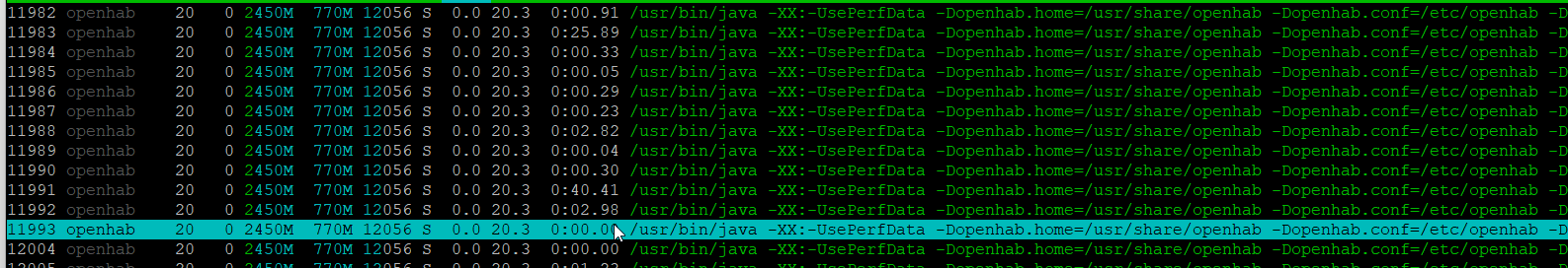

I can see that the CPU load is also very high. I use a raspberry 4 with 4 GB. Memory usage is fine for me but CPU load of one is by 100%.
There are a lot of processes with the same parameters / modules
I’m not sure if the memory settings of these processes are correct or can be changed and if it helps.
To establishing a connection to the Raspberry needs much more longe like before but OH4 itself works for me fine.

One problem what I have : there are a lot of Java processes but no ID to the whatever … item, rules, trigger, … for further version of OH it would help if there is a id which allow a conclusion for whta it is.
Yes. but that’s out of scope of openHAB, these are all child processes of the main java command, maybe a specialized java tool would help
Assuming you’re on a local network and you have a Windows laptop you can try to add visualvm (included in jdk downloads) to the openhab Java process. That shows more detailed information.

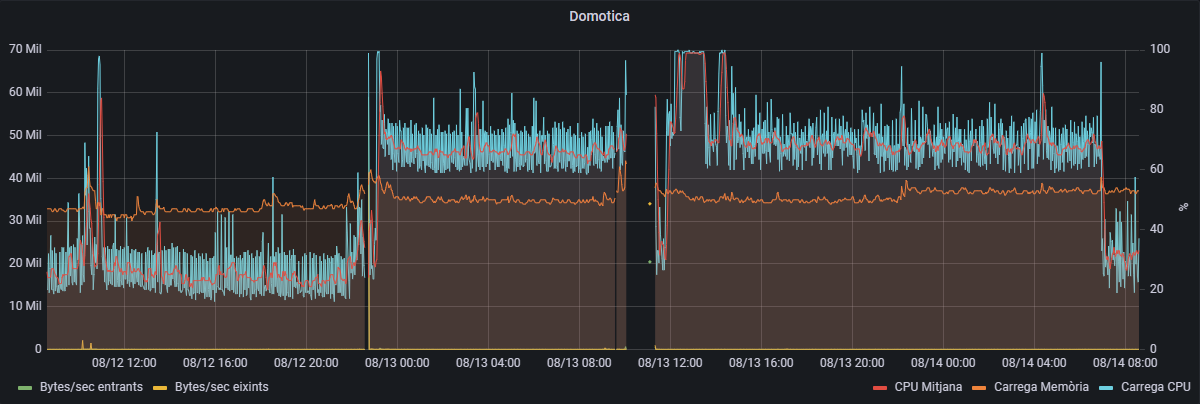

Edited: cache and temp folders cleared after first reboot, because I have problems after that (not before reboot). From then all is working correctly except for the high CPU usage. I have changed the 3 transformations that I use from JS to DSL inline, so don’t have to use JS binding.
Last update: After 36 hours and without any new intervention, CPU usage has been lowered to levels only a bit more than before 4.0.1. I don’t know what happened.
Also memory has increassed only a little more than before.
