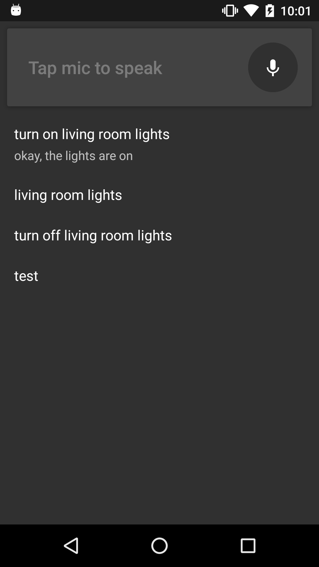

So, in current implementation I have:
  • ability to select an item in settings for voice command (can be different for each client)

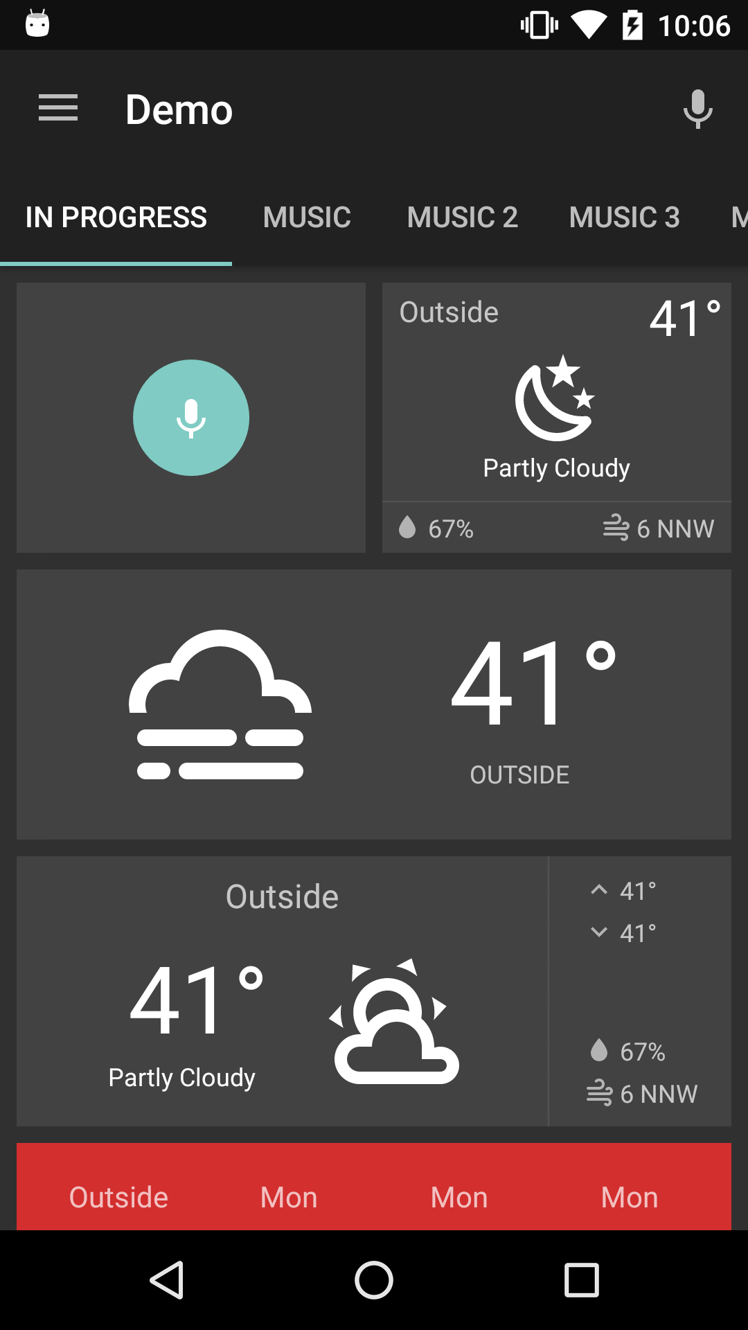

  • voice command widget

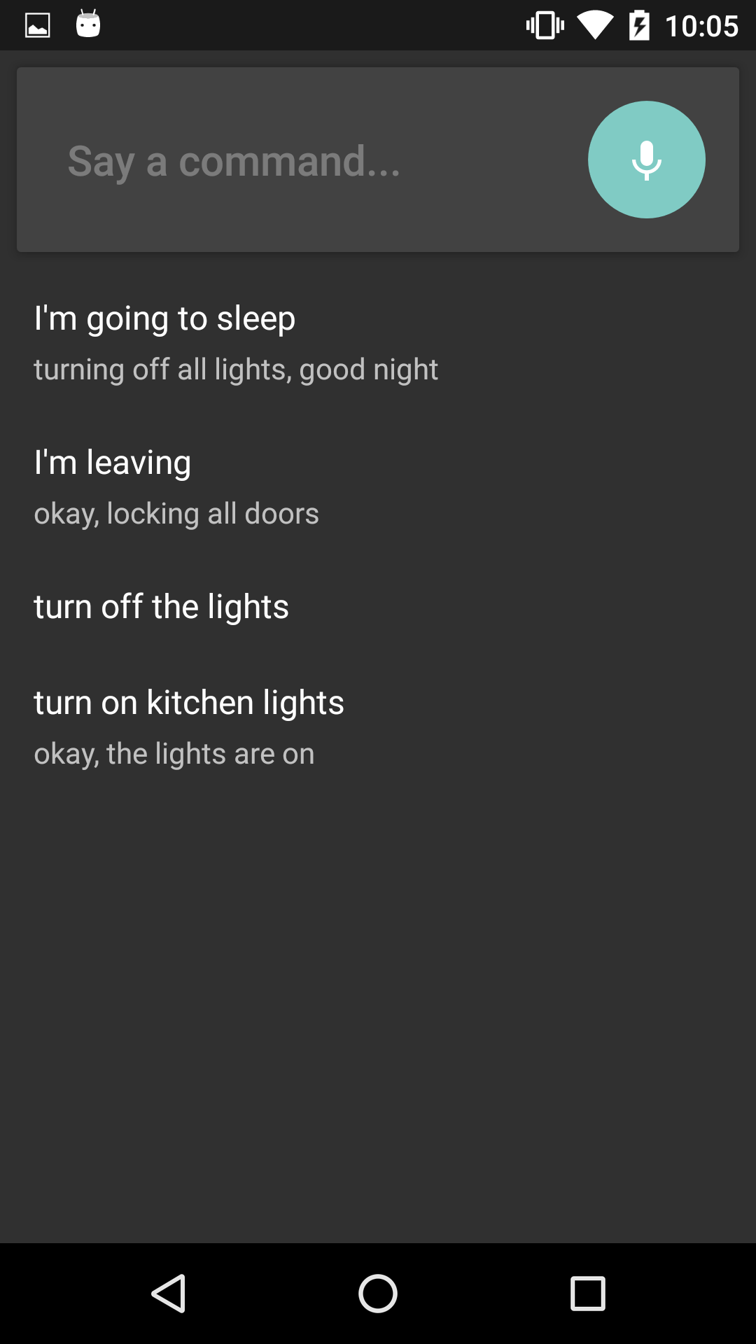

  • voice command screen that stream of commands/responses
  • server responses are being read out loud
  • server can respond by posting update on the same item in following format: VoiceCommand_Igor.postUpdate(“>okay, all lights are off”)
  • server can initiate follow up command after response by: VoiceCommand_Igor.postUpdate(“<”), this will restart the speech recognition in the client
