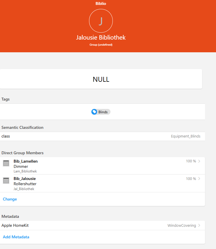

Hi all,
I am new in the openHAB commnuity and did my first steps with Homekit / KNX integration. So far it works fine, but I am facing similar problems with adjustable blinds.
I have created a group with separate items for angle and position like shown above. In “openHAB items” it is shown correct in one group, but on the apple device only one slider is shown.
Does anybody have an idea? Or is additional information needed?
