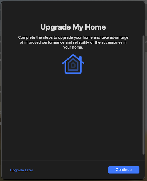

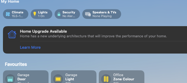

Is it safe to upgrade to the new architecture in HomeKit iOS 16.5 running OH 3.4.4 or is there still issues you should be aware of?

I updated my homekit architecture when I updated my iPhone 12 mini
I just accepted the prompt without thinking
No OpenHAB issues, everything worked fine the first time
But I did have apple device issues
iPad Air 2 and old iMac 2009 (running Catalina) do not support the new architecture.

I’ve upgraded to the new architecture and it seems from some very quick testing to be working fine. When I get a chance I will reboot all systems and try adding a new switch/device, to check it still functions as intended.

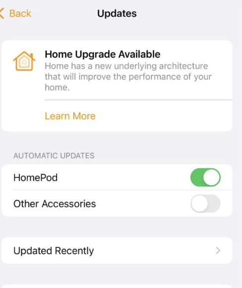

Forgive me if this question was already covered, but does the ā€˜new architecture’ for homekit still exclude using ipad as a homekit hub?
Cheers
That’s correct. This decision was made by Apple and I don’t think it will be reverted. They also write this in the settings app.
