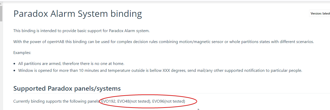

I’ve created a simple binding for Evo systems. Please have a look at this posting where we track the progress of the Evo IP150 binding. The binding is still not in the productive code. It supports only Evo-class security systems since I own one and I could test the coding really well on my own system. The protocol on other Paradox systems seems to differ a lot so I’m not able to provide support for SP-class systems. Current features are only read-only mode reading partitions and zone states.
Please be aware that right now I’m with very limited time to do any changes to the code which were requested by code reviewers so I cannot give any timeline when the binding will go live in productive code.

I’ve been looking around with latest OpenHAB v3, hoping for some more integration in a few things, but for uncommon items such as Paradox, its like @JGKK and @polychronov explained; for the most part in very early stages.
I found that from my panel, a Magellan, there is nothing available ā€˜out of the box’. If you are running an EVO, then you might be in luck as per what Polychronov has put together.

I’m not sure if Magellan uses the same protocol like Evo192 but I guess it’s worth to try the binding on your own. Just install it and follow the instructions to set it up.
I guess it would be best to say that your MG is Evo192 in the bridge config.
Please let me know if it works for you.
