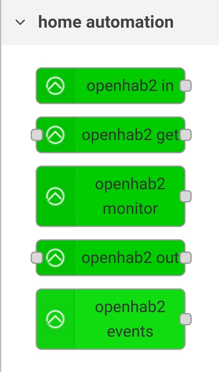

Find the palette manager from the options on the right hand side.
Click on the ‘install’ tab and search for openHAB2
There are a number of versions, my personal preference is “node-red-contrib-openhab2” which is currently at Version 1.1.7
Which will give you

it’s all good, I figured it out after noodling around a bit. Having never used node-red, I was not aware that nodes could be installed via the web gui, and used npm install instead. anyway, it’s working. but yeah, others might find a quick n dirty install/config tutorial, particularly those who are not familiar with node-red. getting node-red installed was no issue, I was mostly uncertain about the best way to get it integrated with openHab, and was not aware of the ability to add the node via the gui. thanks again.
