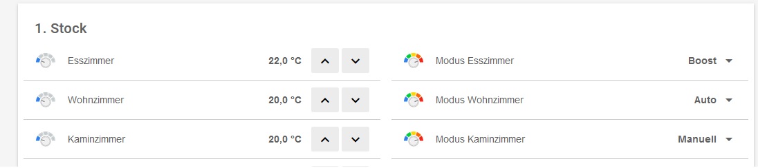

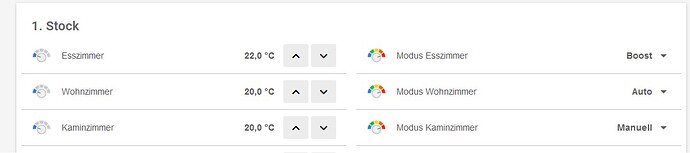

The code i explain works… the thermostats changing the mode as i want to auto, manuell or boost
here are the item…
String   FF_LivingRoom_ModeW       	    "Modus Wohnzimmer [MAP(maxcubeMode.map):%s]"    <heating>       (gHeatingMode)                                      {channel="max:thermostat:KEQ0538054:OEQ1134569:mode"}
the mapping…
AUTOMATIC=AUTO
MANUAL=Manuell
BOOST=BOOST
and the sitemap-code…
Setpoint item=FF_Dining_Heating 			label="Esszimmer" 			step=0.5 minValue=4.5 maxValue=30.0
Selection item=FF_Dining_Mode											mappings=[AUTOMATIC="Auto", MANUAL="Manuell", BOOST="Boost"]
Setpoint item=FF_LivingRoom_HeatingW 		label="Wohnzimmer"			step=0.5 minValue=4.5 maxValue=30.0
Selection item=FF_LivingRoom_ModeW										mappings=[AUTOMATIC="Auto", MANUAL="Manuell", BOOST="Boost"]

The Dining Mode is to setup the thermostats in the automatic-mode (with programmed timetables), manuell (without) or boost mode (open the thermostat to maximum for 300 seconds).
All of this modes have nothing to do with the actual heating temperature.
This temperatures i simply set over setpoint items…
I think it will be the same probleme, because i think that the rule would need also triggering item…
But what does that mean in terms of commands sent to Items.
What should happen when you set FF_Dining_Mode to Boost in terms of commands sent to other Items? What command(s) need to be sent to what Item(s) to “open the thermostat to maximum for 300 seconds”? The answer to that question will tell you what the rule needs to do.
