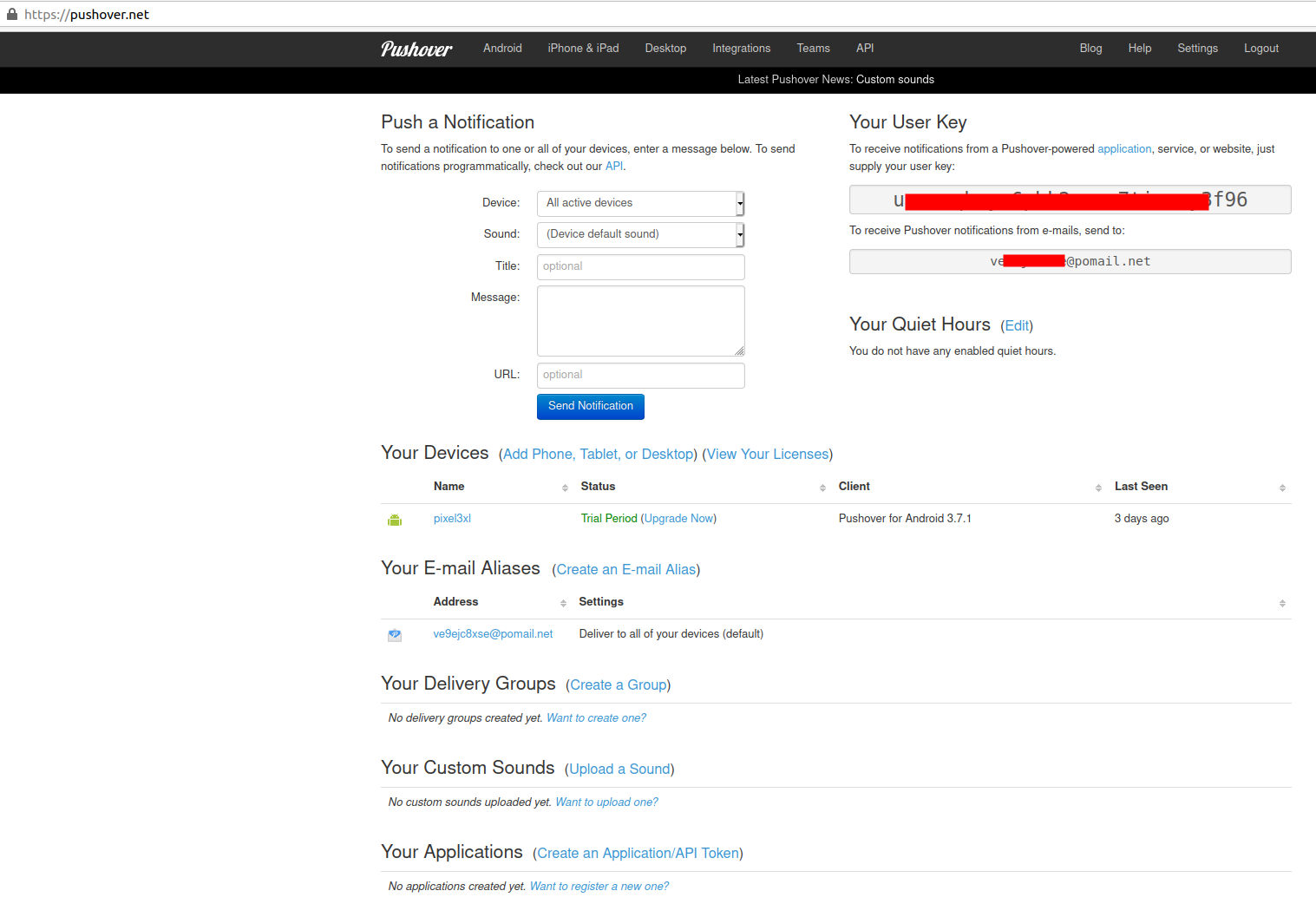

  • step1 - Sign-up to pushover service
    In there I see a User Key (u…f96), and email (v...@pomail.net) (see snapshot1)
    I verified that the account is registered by going to https://pushover.net/ (unrelated to oh3) and sending a test notification which appeared in the mobile phone as expected.

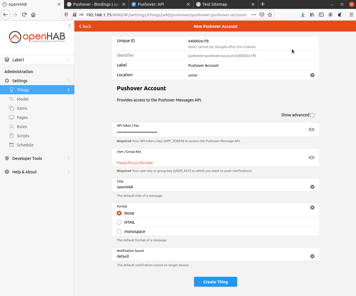

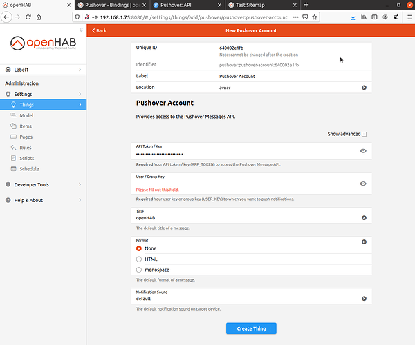

    In oh3, to add the pushover Thing (see snapshot2), I’m required to provide:
    • API Token / Key
      Required Your API token / key (APP_TOKEN) to access the Pushover Message API
    • User / Group Key
      Required Your user key or group key (USER_KEY) to which you want to push notifications.
I don’t know what to place in the these 2 required fields. I tried to insert:
  • the API token from OpenHAB to API Token / Key
  • the User Key from the Pushover account to the User / Group Key

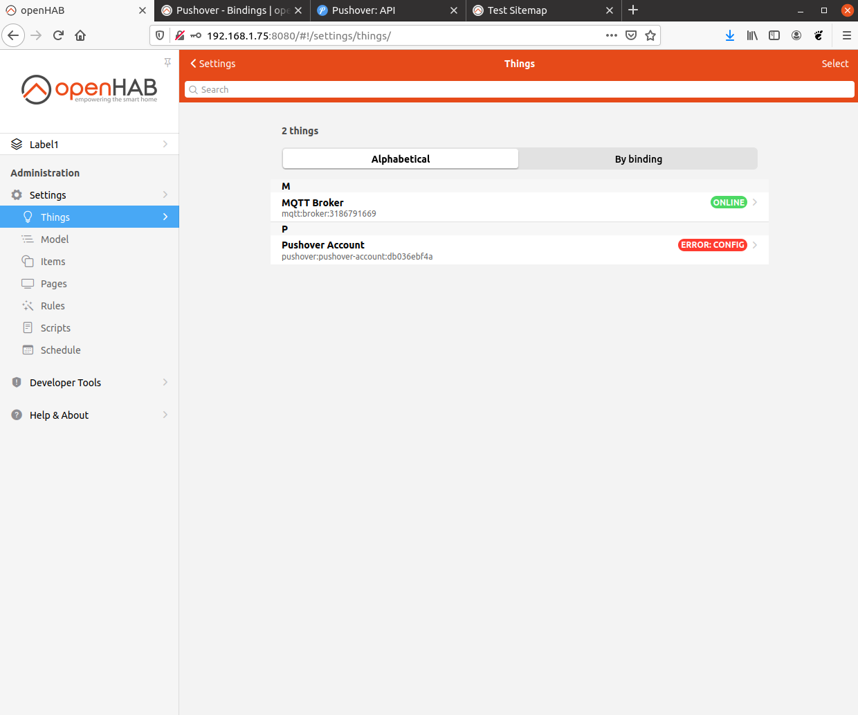

    But I’m getting an error: ERROR:CONFIG application token is invalid (see snapshot3)
What should I do to add the New Pushover Account Thing successfully?

snapshot1 - pushover sign-in page
snapshot2 - Adding New Pushover Account Thing
snapshot3 - error adding a Pushover Account Thing

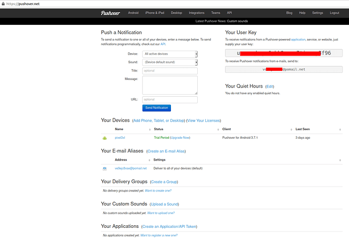

Just for reference, it seems the step that you were missing for pushover, is to register your application to get an api key:
