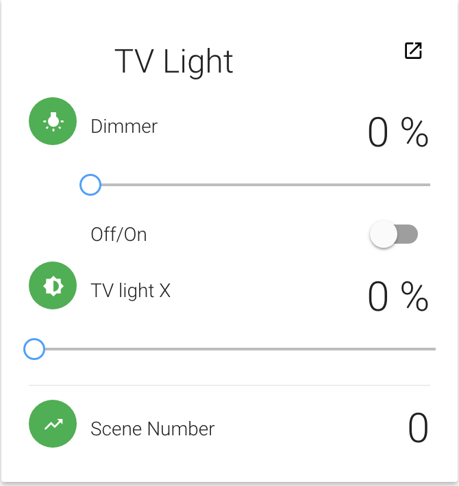

Indeed I get a dimmer scrollbar in PaperUI… what I don’t get is what a zwave thing shows in paperui, that is a dimmer scrollbar PLUS an on-off switch. Which shows through on the smartphone OH app too. The MQTT channel types don’t have a ‘dimmer’ type and thus PaperUI doesn’t render the scrollbar plus the switch… this is my assessment thus far, if I am wrong, please do share a solution?
The config thus far:
The display in PaperUI:
iridium_RxLbjHKEH6
As we can see, I had to add TWO channels in order to get both a dimmer and the ability to switch. Zwave things get representation of both facilities through just ONE channel.

In PaperUI when a dimmer ‘item’ is binded to a percentage ‘channel’ of an MQTT ‘thing’, we only see a scrollbar, no additional ON/OFF switch.
However, when doing the same with a Zwave thing, the channel-type of ‘dimmer’ is selected automatically by default according to how zwave classes function. This then binds to an item type ‘dimmer’ and accordingly shows a scrollbar and a switch representing that dimmer ‘channel’.
So my conclusion is that because we do not have a channel type of dimmer available in an MQTT thing configuration, only the type of ‘percentage’ being the valid choice as you advised out of the type collection, a binded item type of dimmer to that channel will not display a switch… is this a bug? or simply by design?
Keep in mind that in the MQTT thing channel configuration it shows ‘dimmer’ as type for that channel even though I chose only ‘percentage’ out of the available channel-type options which do not include ‘dimmer’, yet we still do not see a switch as well as the scrollbar when PaperUI renders that item.
