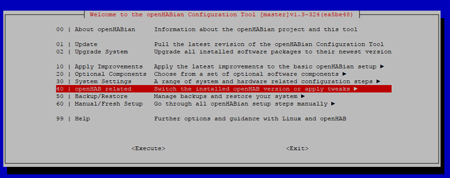

Step 1: login via ssh and run the openhabian-config tool
$ sudo openhabian-config

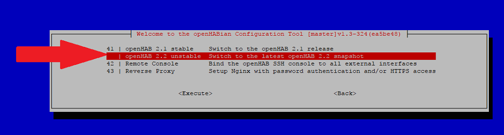

Step 2: Choose the option to “Switch the installed openHAB version or apply tweaks”. on the next screen, select “openHAB 2.2 unstable

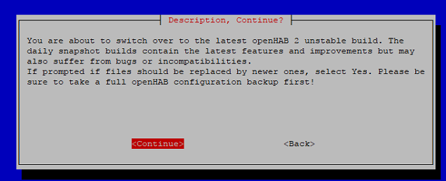

Take warning! Continue at your own risk… (recall my note above about making backups…)

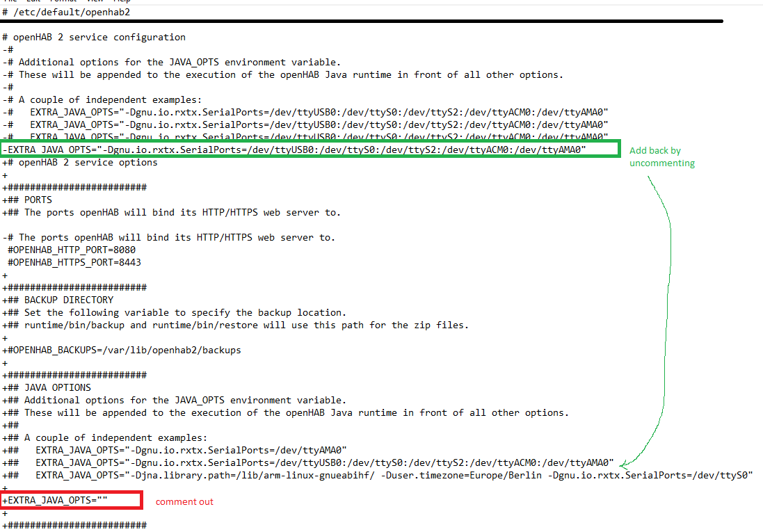

Note: IMPORTANT: The next message instructs you to replace current configurations files with the newer ones… this WILL potentially remove any of your custom configuration which you will likely want to take note of and, add back in once the install completes. Therefore, it would be wise to run the DIFF option when prompted in order to see what is being removed so that you can add it back in after the installation completes. (more below)
at the shell prompt, the installer will ask you to overwrite configuration files with the newer versions. select option D for Diff to see the changes. (take note, copy to text editor etc)
take note, press q to quit diff. Then Y or I to accept newer version.

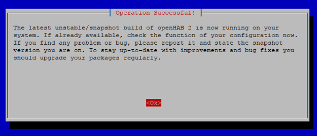

Once finished, you should see the following screen.
Now, go back and edit/update your config files as needed. Here is an example where I had to add back in to get my AEOtec Z-Stick working again. (followed by restarting openhab2)
Reference: http://docs.openhab.org/installation/linux.html#privileges-for-common-peripherals
