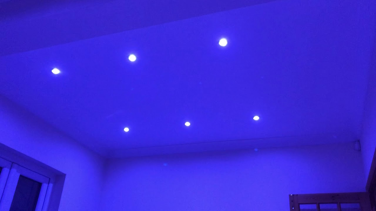

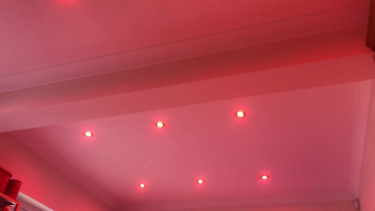

Strangely, when I play this video back and my alexa hears it and carries out the commands it’s different bulbs that play up each time, there seems to be no logic to it.
No errors in openhab log either!
Seems to only happens when you go from OFF to a color.
