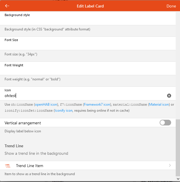

It is also no rocket sience to use your own icons.
Depending on your operation system you just put the icon (e.g. test.svg) in the folder: $OPENHAB_CONF/icons/classic/
When using OH3 and the mainUI you just link the icon with e.g. oh:test to your widget:
Anything else you need to know?
