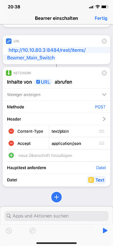

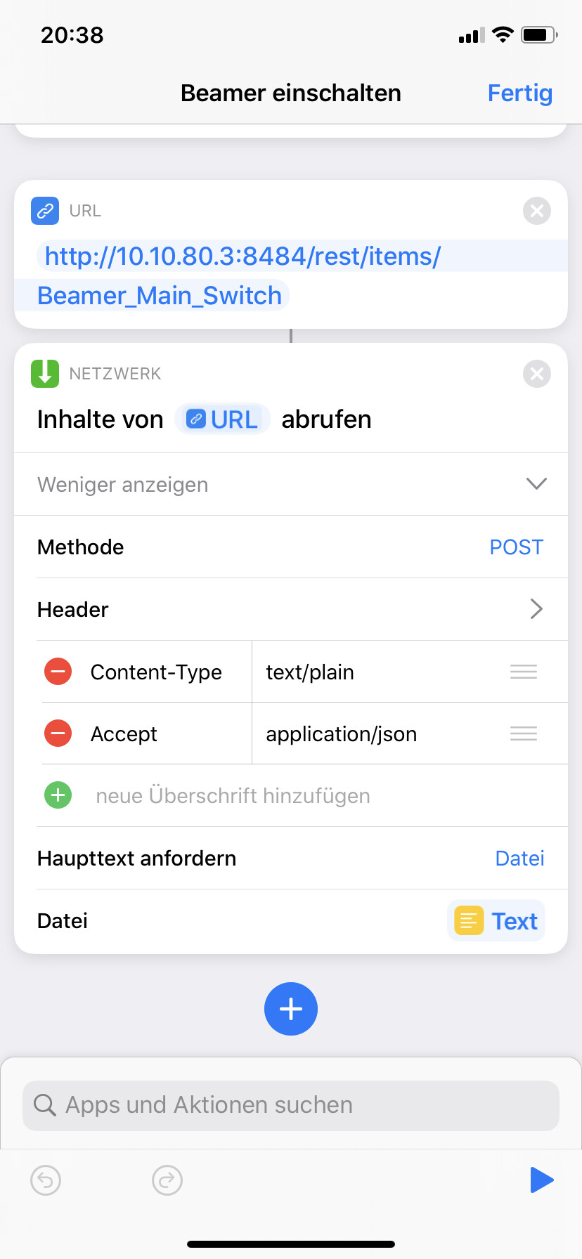

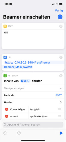

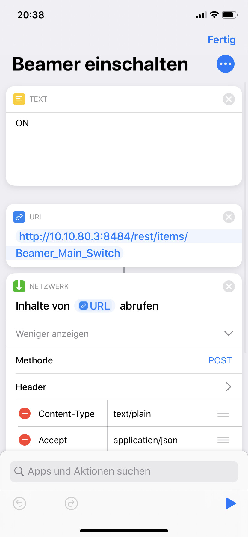

Look for the App Shortcuts in German Kurzbefehle … with this App you can post via Siri Events to the RestAPI… so you have Full Access via Siri to every Item of Openhab :slight_smile:
Hey Siri → Beamer einschalten
PS: iOS 12 or later

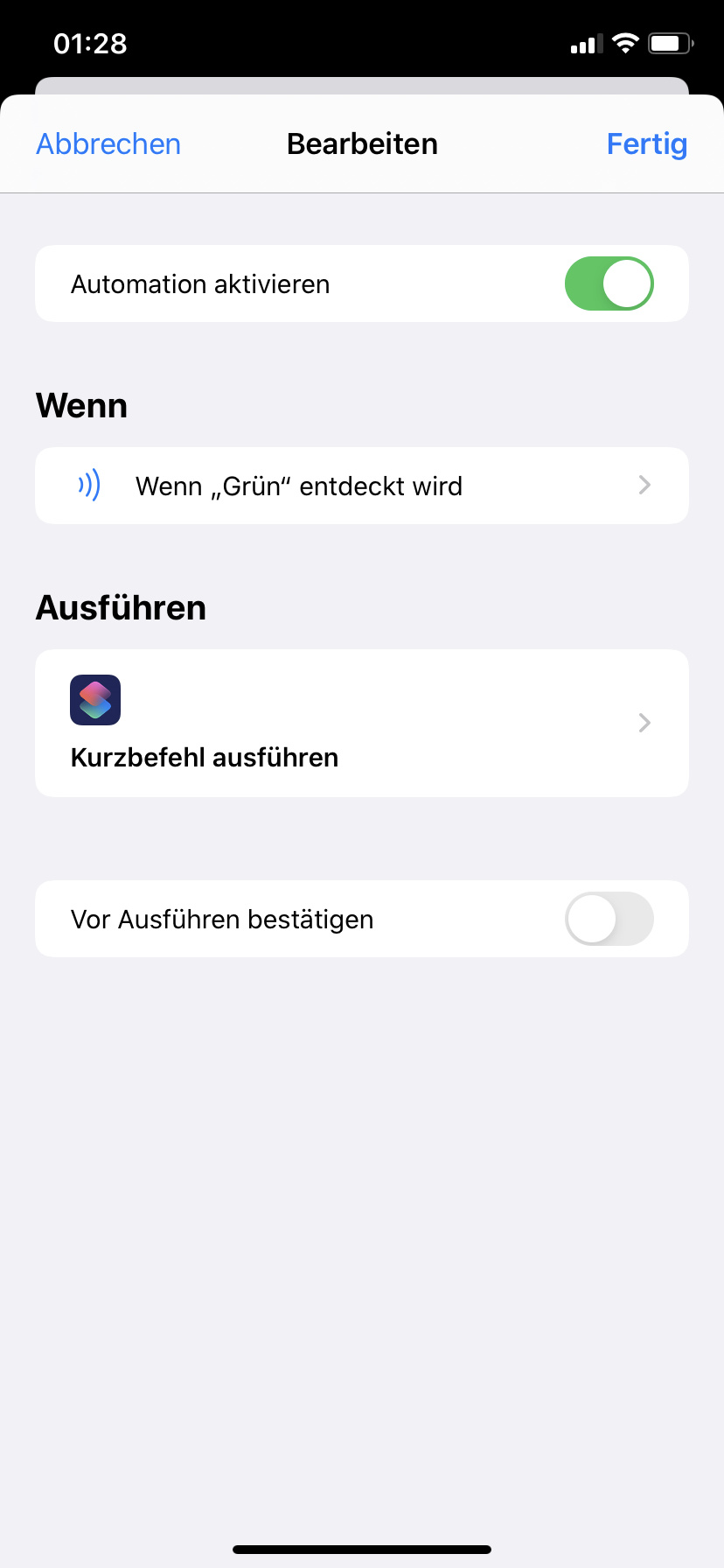

A nice Szenario is NFC Tag & Shortcuts :slight_smile:
AppleWatch :sunglasses: (Only testet with iPhone … I have a Apple Watch Zero without Shortcut Support)
Here my Shortcut and the NFC Config in Screenshots:
