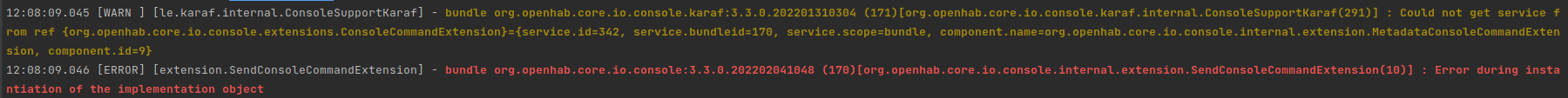

My problem is that when I run my modification with the OpenHAB distro project I get the following errors in the OpenHAB log:tail command:
frame_error

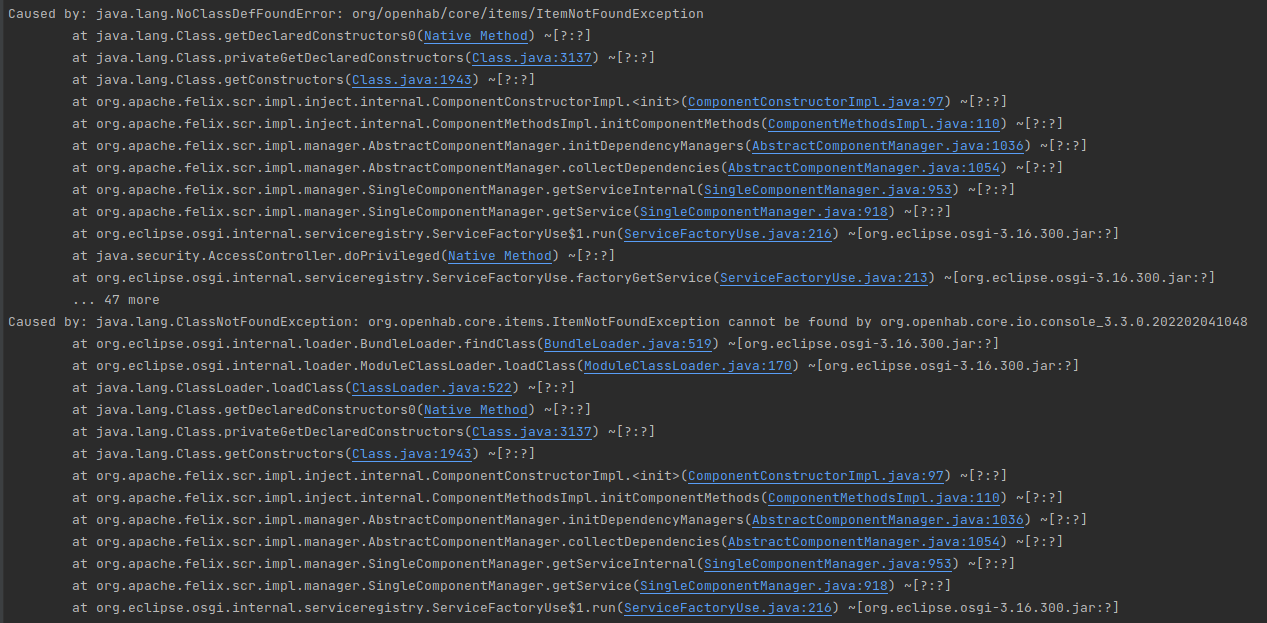

And when I restart the bundle I modified, it shows :
In this post in stackoverflow he explains that it is due to my package version but it is strange because all my packages (yar files) have version 3.3.0-SNAPSHOT and when I build my bundles with mvn clean install, everything is built successfully.. Does anyone know what the problem is?

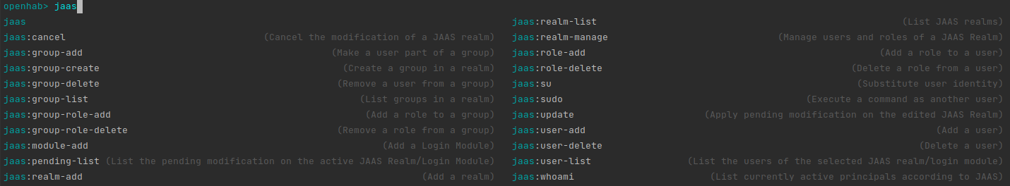

I saw in the openhab console that there are the following commands with jaas (Java Authentication and Authorization Service):
So there is already a command to add a role, remove a role, … but these commands are not implemented yet? Actually, I implement these commands in the openhab:users command and not in jaas. Can I implement these commands in openhab:users? If not, in which file should I implement these commands if it is with jaas?
