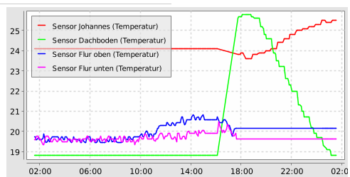

In my sitemaps with chats the old and new written persistence Data is shown but in the OH3 schematics UI when I select an Item only the data written on the new system is shown.
Example Temperature Data in Sitemap Chart:

The shown chart looks like this in the sitemap:
Frame label="Raumtemperaturen Graph" icon="line"{
        Switch item=chart_period label="Zeitraum:" mappings=[0="Tag", 1="Woche", 2="Monat", 3="Jahr"]
        Chart item=gTemperatures period=D refresh=30000 visibility=[chart_period==0, chart_period=="Uninitialized"]
        Chart item=gTemperatures period=W refresh=30000 visibility=[chart_period==1]
        Chart item=gTemperatures period=M refresh=30000 visibility=[chart_period==2]
        Chart item=gTemperatures period=Y refresh=30000 visibility=[chart_period==3]
        Chart item=gHumidities period=D refresh=30000 visibility=[chart_period==0, chart_period=="Uninitialized"]
        Chart item=gHumidities period=W refresh=30000 visibility=[chart_period==1]
        Chart item=gHumidities period=M refresh=30000 visibility=[chart_period==2]
        Chart item=gHumidities period=Y refresh=30000 visibility=[chart_period==3]
