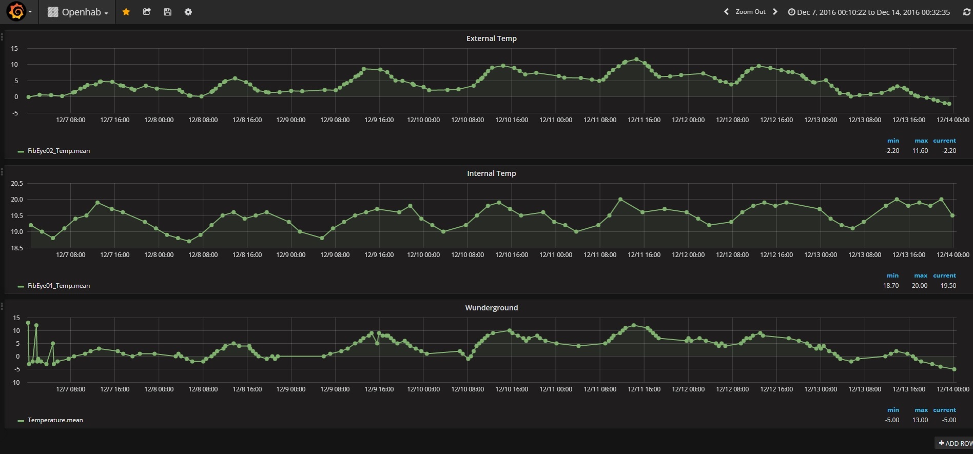

Hey @ThomDietrich how can the points be connected? (Value “Ping”)
Hey, you need to select Draw Mode Lines. Your diagram uses Points.
