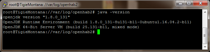

output of java -version ?

Should I go with the Oracle proper version of Java, instead of OpenJDK?
Yeah, try Oracle to see if things improve
or even better: Zulu

Also, since your java -version is showing Oracle, then your system is configured to use it as default (you can check with update-alternatives --config java)

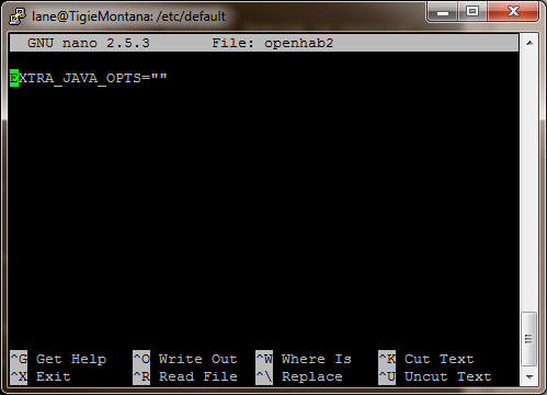

/etc/default/openhab2
# openHAB 2 service configuration
# Additional options for the JAVA_OPTS environment variable.
# These will be appended to the execution of the openHAB Java runtime in front of all other options.
# A couple of independent examples:
#   EXTRA_JAVA_OPTS="-Dgnu.io.rxtx.SerialPorts=/dev/ttyAMA0"
#   EXTRA_JAVA_OPTS="-Dgnu.io.rxtx.SerialPorts=/dev/ttyUSB0:/dev/ttyS0:/dev/ttyS2:/dev/ttyACM0:/dev/ttyAMA0"
#   EXTRA_JAVA_OPTS="-Djna.library.path=/lib/arm-linux-gnueabihf/ -Duser.timezone=Europe/Berlin -Dgnu.io.rxtx.SerialPorts=/dev/ttyS0"
EXTRA_JAVA_OPTS=""
# The ports openHAB will bind its HTTP/HTTPS web server to.
OPENHAB_HTTP_PORT=8081
OPENHAB_HTTPS_PORT=8444
No comments, just the EXTRA_JAVA_OPTS=“” line.
The server is defaulted to port 8080, but I could add the line to change that.

yeah, add the 2 lines to change the default ports that OH2 will listen to
Ps: The extra comments were added in the file during a recent snapshot (I think S#947)
