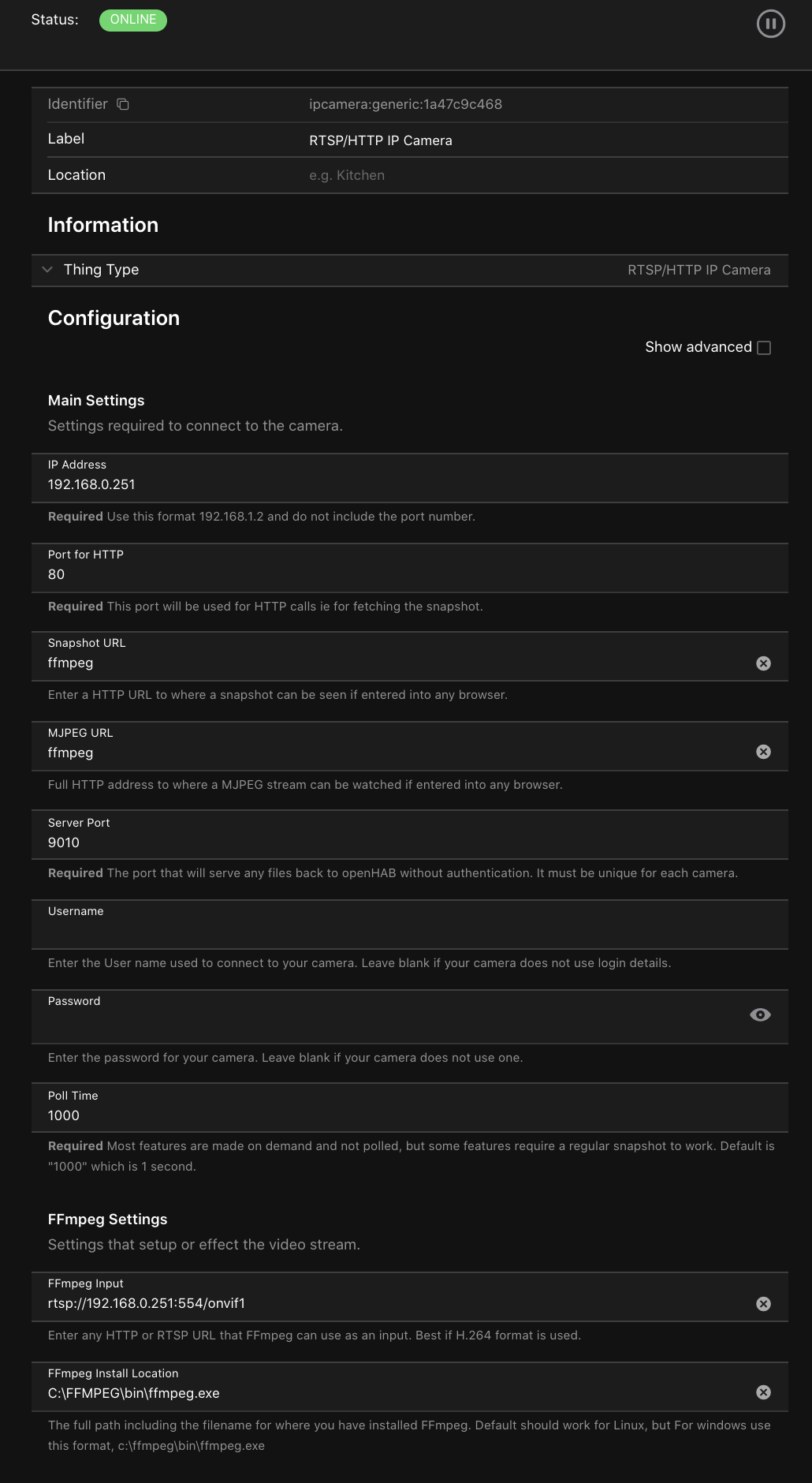

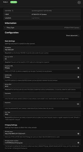

I successfully added a Reolink camera.
But having problems adding my doorbell with only a rtsp stream and no username and password.
Enabled tracing and this what I get with no username and password:
2021-10-23 14:05:35.305 [DEBUG] [pcamera.internal.StreamServerHandler] - Stream Server recieved request 	GET:/ipcamera.mjpeg
2021-10-23 14:05:35.306 [DEBUG] [hab.binding.ipcamera.internal.Ffmpeg] - Starting ffmpeg with this command now:********-********r********t********s********p********_********t********r********a********n********s********p********o********r********t******** ********t********c********p******** ********-********h********i********d********e********_********b********a********n********n********e********r******** ********-********l********o********g********l********e********v********e********l******** ********w********a********r********n********i********n********g******** ********-********i******** ********r********t********s********p********:********/********/********1********9********2********.********1********6********8********.********0********.********2********5********1********:********5********5********4********/********o********n********v********i********f********1******** ********-********q********:********v******** ********5******** ********-********r******** ********2******** ********-********v********f******** ********s********c********a********l********e********=********6********4********0********:********-********2******** ********-********u********p********d********a********t********e******** ********1******** ********h********t********t********p********:********/********/********1********2********7********.********0********.********0********.********1********:********9********0********2********0********/********i********p********c********a********m********e********r********a********.********j********p********g********
Somehow the FFMPEG parameters are completely garbled. Not sure if this caused by the binding or some other problem in OpenHab
I fixed a bug that does that when there is no user/ password. It is fixed it the jar you can download in this thread.
