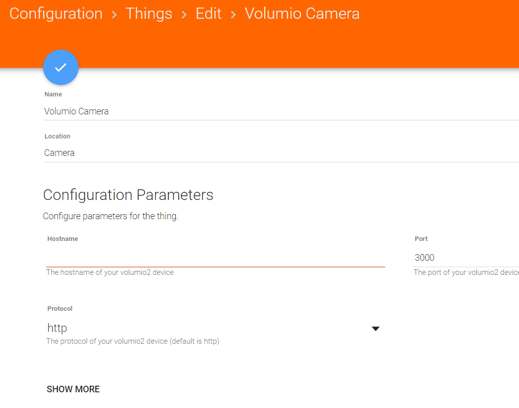

Hi Patrick, after some time the device goes offline. If I go to the Things edit I see I lost Hostname value.
If I put ip address in hostname and save the thing goes online, then after sometimes it lost again the value. Can you please help me to solve this problem?

Hi Massimo,
I have the same issue, as a workaround I created the thing in a textfile and used the same name/id as paperUI:
Thing volumio2:player:06417617-77ff-4108-b55c-0177f45280fd "Volumio Garage"  [ hostname="volumio01.lan.domain.tld", port=3000, protocol="http"  ]
(name/id is the last part of the paperUI url while editing the thing) The only side effect I have is a volumio device permanently in my inbox.
Hi Tom, thank you this solve the lost hostname and offline problem.

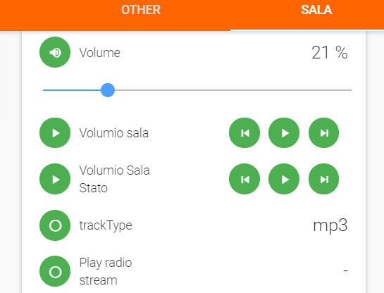

Now play, pause,next and previous song are working well. In paper UI I can’t see always the title/artist.

Hi, thank you Tom. This solution work but I have to delete the player item created by the binding beacause I had two player items:
I thought that I coudn’t delete items created by the binding but i was wrong. :smile:
