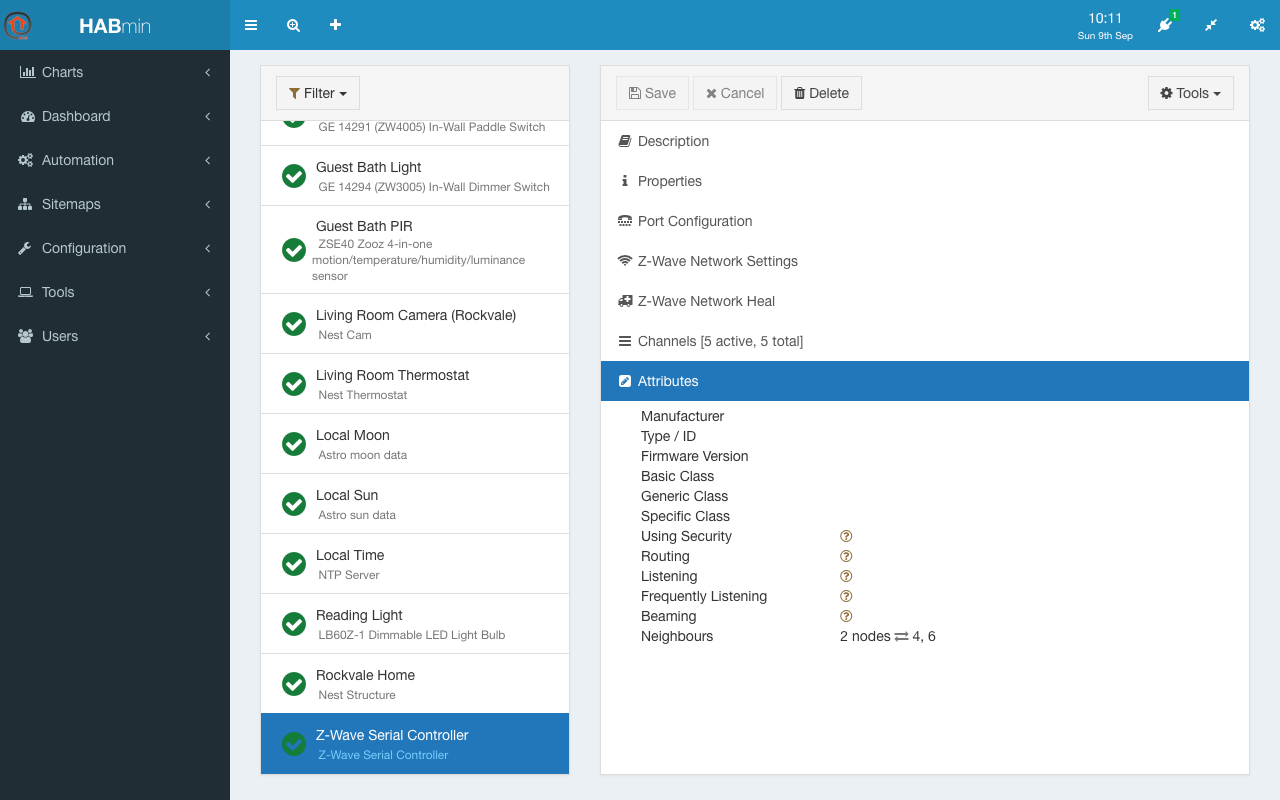

I am brand new to openhab and I am running it on RPI3 with a Razberry daughter card and openhab2 standard. I have a couple issues. I did a hard reset of the controller before I realized that it would reset it completely and I would loose everything. Now, when I am in HABmin and I look at the attributes of my zwave serial controller “Thing” it has nothing but question marks. Please see pic. How do I fix that?48%20AM
