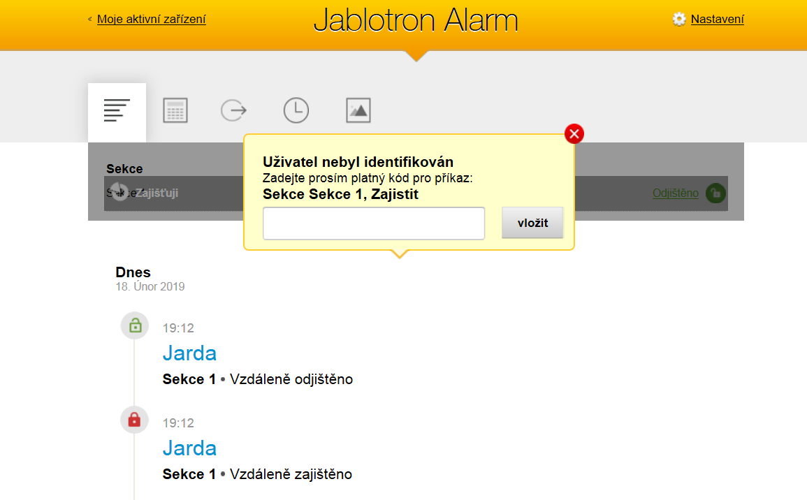

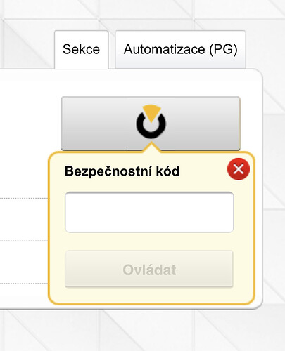

Hmm, it seems there are difference between JA-80 and JA-100.
I have gor on my keypad extra keys for controlling PGMs or SECTIONs.
It might be, but if you use the control from web (http://jablonet.net), how does the control widget look like? can you send me a snapshot of it?
The ja80 control widget is attached…
Ondrej

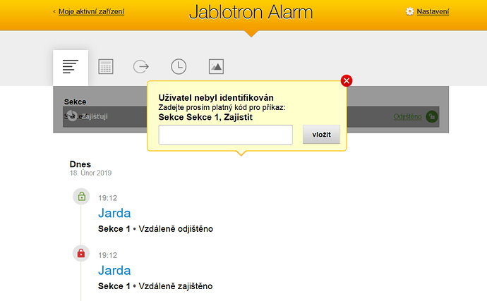

After clicking on DisArmed it needs auth code.
Only for first time. Next Armed/Disarmed operation is without promt for auth code.
Ok,
thanks for the info - and what sort of code are you engering? Is it some master/universal or a code relating to the required activity - e.g. arming/disarming?
why i am asking - if you use the universal code, the kind of action must be sent with the code as well, otherwise the alarm cannot recognize the requred action…
O.
You are right. I am entering only auth code. JA-100 has only auth code.
I am choosing button for PG / Section and than entering auth code on the web. JA-100 dosnt support code for operation.
My question is how can I set status of section and the same time send auth code?
Thanks.

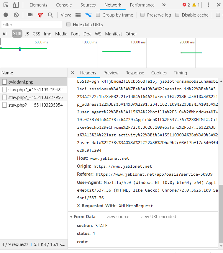

if you can sniff the communication between https://jablonet.net in Chrome debug (F12 key, network tab), it would be great.
I need to see the parameters sent via PUT command to ovladani2.php endpoint (ja80 oasis has ovladani.php endpoint)
Afterwards we can move further.
Thanks.
Ondrej
Hi Ondrej.
did you mean this?
Form Data:
section=STATE_1&status=1&code=1234
Thanks.
yes,
how does this form DATA differ for arming, disarming and partial arming?
the section parameter is clear - it means the section name, but I do not understand the status parameter (it really sets the state of a section to 0,1,2?) and need to confirm, whether the code is always the same - the master code or not. If the master code is always the same, the solution might be to have this code as an optional configuration parameter of JA100 alarm thing and let the user only to send 0,1,2 to a section…
Thanks.
Ondrej
yes, me only 0 or 1
0 is disarm
1 is arm
and you do not use partial arming?
