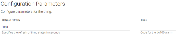

I have prepared a new version, which has config parameter code for JA100 thing.
This parametr is used for storing your master password, so the binding can send section=STATE_1&status=1&code={code}
can you test it and let me know?
if you set the master code, this should be working:
for arming
sendCommand( mySection1, 1 )
and for disarming
sendCommand( mySection1, 0)
If you do not see the new config parameter, please remove and readd the JA100 thing (via autodiscovery)
Thanks.
Ondrej

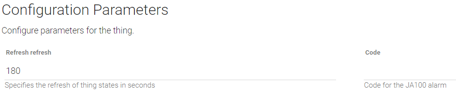

What is the name of new parameter?
I dont see it (removing and readding JA100 doesnt help)
its name is code
you can find it on the JA100 thing configuration page…

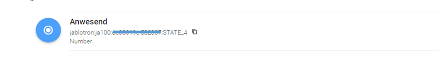

Hello!
I have a Jablatron 100! I have the binding installed. It will be synonymous all area correctly.
However, I can not make a circuit! What could have been wrong?
It is also time information from the alarm system! Only I can not set area Sharp / Unschaf! What could be the reason?

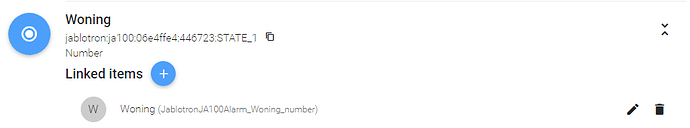

Hi, so i got the PG’s al working now, but I am struggeling with controling the alarm.
I have only one section. I think I am configuring it wrong. In the items list, it shows as a ā€˜number’ item (I guess becouse the output is 0 for disarmed, and 1 for armed). I have linked it as a number item, and when i manualy set the alarm on the keypad, I can see the value change from 0 to 1.
But what do I have to configure in order to also control the section?
Thank you in advance!
glad you have made PG’s working (just curious what was wrong?). The section controling accepts number 0,1,2 (0=disarmed, 1/2 is armed/partially armed - not sure how exactly. That’s why it has three states and not only On/Off as switch)
Just use sendCommand( alarmSection, number) to arm/disarm, arm partially
I’am using this similary with JA-80, I have buttons (switch) for arming (garage, house partial, house) and one button for disarming.
If you follow this way the only thing you need is to write a rule to send a conrete command when you click the button…

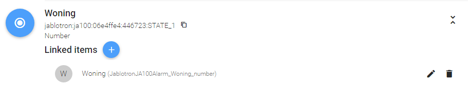

Hi @Ondrej_Pecta
I created a widget that has a button, and I programmed it like this:
<button ng-if=ā€œitemValue(ā€˜JablotronJA100Alarm_Woning_number’)==ā€˜0ā€™ā€ ng-click=ā€œsendCmd(ā€˜JablotronJA100Alarm_Woning_number’, ā€˜1’)ā€
But it does not arm my section .. What am I doing wrong?
I do not use these widgets so I can’t tell you if there’s something is wrong.
What says the debug log?
Have you tried sending a number insted of string?
sendCmd(ā€˜JablotronJA100Alarm_Woning_number’, 1)
