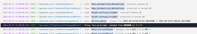

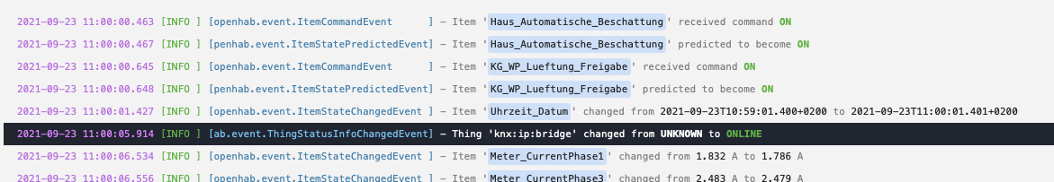

after the power loss rest my system the knx binding won’t work.
i rebooted several times - the server itself and the network peripherals as well as the bus completely but nothing seemed to work.
The bus works fine and i can program the ip router but for some odd reason the device won’t show online in the UI although the logs show it as ONLINE.

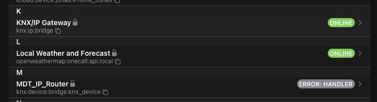

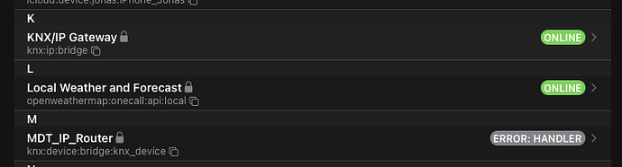

The bridge seems to work but the device has a handler-error.
If i change the items via REST API the item change is logged but nothing is received on the bus (diagnose-window in the ets always showed the commands via tunneling)

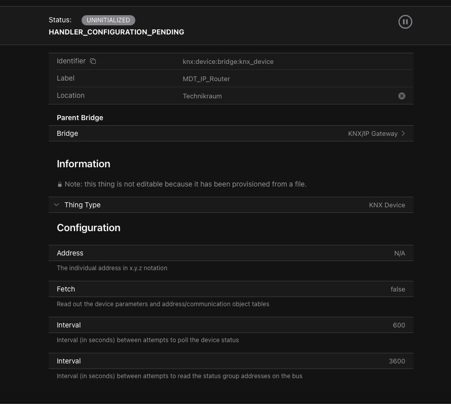

i cannot get it to work. when i restart OH the Device shows “Handler missing”.
Are there too many items in the one knx-thing?

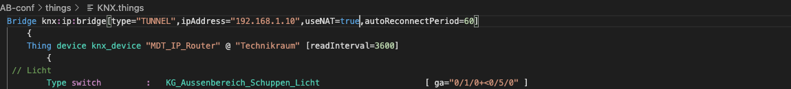

I split it up like you did now and everything is coming online except for “Lichter”. Still Error Handler missing.
I cannot see any mistake in my “lichter” config …
maybe someone can see something i cannot:
Bridge knx:ip:bridge [
    type="TUNNEL",
    ipAddress="192.168.1.10",
	 portNumber=3671,
    useNAT=true,
	 readingPause=50,
	 responseTimeout=10,
	 readRetriesLimit=3,
	 autoReconnectPeriod=60,
    localSourceAddr="0.0.0"
    Thing device Licht "KNX Lichter" [
        readInterval=3600
        Type switch         :   KG_Aussenbereich_Schuppen_Licht                     [ ga="0/1/0+<0/5/0" ]

        Type dimmer         :   OG_Bad_LED                                          [ switch="0/1/47+<0/5/47",position="0/3/47+<0/6/47",increaseDecrease="0/3/97" ]
        Type switch         :   DG_Deckenleuchten	                                 [ ga="0/1/48+<0/5/48" ]
Edit:
I found it.
One Switch item (OG_BAD_Spiegelbeleuchtung) was wrong. (switch instead of ga=“” …)
Now it’s working again :slight_smile:
