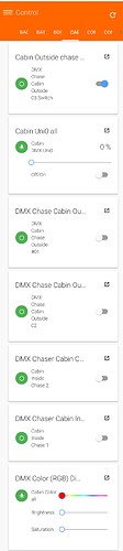

Thanks to Jan, I’ve got loads of DMX / Art-NET stuff running around my house.
Here’s the PaperUI Control section just for 1 room.
With lots of chases and colour pickers.
