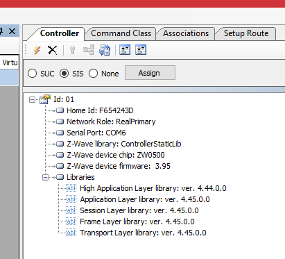

I guess it’s possible Nortek updated something, but I would expect a firmware update available if they had. You could compare the version of the libraries between the zstick and quickstick in Zensys Tools. Mine were identical. This is my zstick:
That is what my zstick looks like, the husbzb-1 has the identical libraries, but it’s z-wave device firmware is 4.05. I’ve tried the backup / restore on a different machine and it the whole process seems to succeed but the husbzb-1 is still un-restored. Does your husbzb-1 have a firmware version of 4.05?
