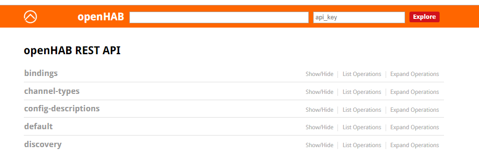

I have upgraded to M2 and changed the addons.cfg for the restdocs:
# A comma-separated list of UIs to install (e.g. "ui = basic,paper")
ui = basic,classic,habmin,habpanel,paper,restdocs
But the REST API interface is down:
The text is:
500 : <html> <head> <meta http-equiv="Content-Type" content="text/html;charset=utf-8"/> <title>Error 500 Request failed.</title> </head> <body><h2>HTTP ERROR 500</h2> <p>Problem accessing /rest/swagger.json. Reason: <pre> Request failed.</pre></p><hr><a href="http://eclipse.org/jetty">Powered by Jetty:// 9.4.18.v20190429</a><hr/> </body> </html> http://openhab:8080/rest/swagger.json

It works for me.
Try removing the api from addons.cfg and adding it through the PaperUI. That is the preferred method anyway.

I have it installed through the PaperUI, not the addons.cfg.
I tried both. No dice
Does not work for me. I’m on build 1672.
I am installing via addons.cfg… but that cannot be the reason this fails, surely.

If that is after 2.5M2 it may be broken again. It was broken until slightly before the M2 build.
I downgraded from 2.5.0~S1672-1 to 2.5.0~M2-1. I’ve been working on trying to get MQTT2 configured and now my Generic Broker connects successfully. Unfortunately REST Docs are still not working.
It seems to be a conflict where some bindings installs a different version of the Jackson library which causes the swagger.json to fail generating.
The rest API should still work though, just not the docs.
The rest API works. I confirm that. Not the docs…
Do you have the Jinja Transformation addon installed?
That “killed” REST for me. After removing Jinja REST docs also worked again.
Might be worth a try.

Do you have the chromecast binding installed? If so, remove it and see if the issue goes away.
Jinja not installed. Not the issue
I rely heavily on chromecast audio messages. Don’t really want to do that.
Yes, for me it appears that the conflict for me is due to the Chromecast binding. @rlkoshak pointed this out to me in another topic as well. In the latest milestone the Chromecast binding must install Jackson 2.9.x.
I do not have the Jinja transform addon installed.
I don’t want to remove the Chromecast binding to test because I have a dozen devices for which I have linked several Items to their channels.
Mike
Understood. I only was suggesting you remove it to see if it clears the issue. Obviously, a non-working restdocs is preferable to no audio messages. :wink:
There’s a chromecast fix in the pipeline, I just don’t know if it’s been merged yet.
I’ll do a test early in the morning when I am “alone” to test the theory.
Here’s the PR that I think will fix it. It was merged, but I don’t think it’s in the build yet.
https://github.com/openhab/openhab2-addons/pull/5949
