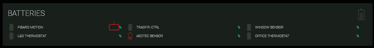

Hello forum,
I can’t display the % value of the particular battery status in my group :frowning:
I tried item.status, item.value … without success. What do i do wrong?
<div class="title">Batteries</div>
  <div class="controls">
  <div ng-repeat="item in itemsInGroup('gBattery')">
    <div class="widget wide" ng-if="itemValue(item.name)>='90'">
	 <div class="icon off"><svg viewBox="0 0 48 48"><use xlink:href="/static/matrix-theme/squidink.svg#charging-3"></use></svg></div>
     <div class="name">{{item.label}}</div>
	 <div class="valueGroup">
		<div class="value">{{item.value}}%</div>
   	 </div>
    </div>
  </div>
no feedback at all :frowning:
Have you tried itemValue(item.name)?
yes. it returns only the name of the item
EDIT: did a quick spike and seems as below is working

@wiewior - please note you probably have to remove apostrophe in >='90' so >=90.
With the code above I can see which (dimmer) lights are turned on more than 50% …
This can not work. There is a loop for going through all of the sensors in the group. So I need to refer to the each of the item.name and its value. Somehow it does not work and I do not know how to debug this kind of code…:frowning:

Thank you @crnjan . Indeed WORKS! Removing apostrophe did the magic!!
Appreciate.

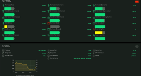

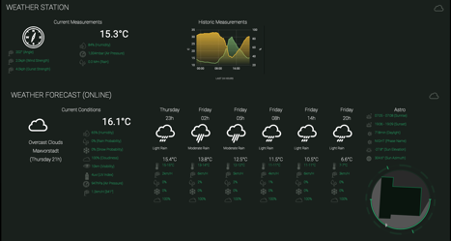

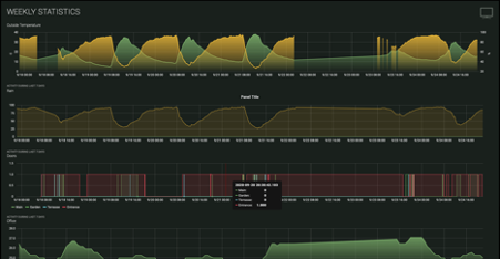

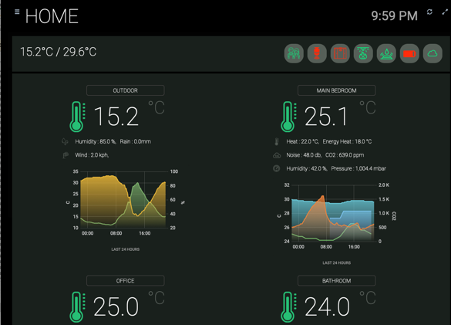

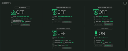

Since I took so much inspiration from this forum I’d like to share my own result.
Essentially it’s based on the matrix template with only minor modifications ..
Many of my devices are battery powered. I still do not trust those Z-wave devices 100% therefore regularly check for the last battery update. In case the update is older than 24 hours the icon get’s coloured in red as a warning of a potential offline-state.
The weather widget I did by myself (almost everything else is picked from somewhere ..). Sun Position comes from < Show Current Sun Position and Shadow of House (Generate SVG)>
S-Bahn schedule comes from < [Deutsche Bahn Monitor - Denkanstöße gesucht - KNX-User-Forum]
Calendar : < [Solved] Show Google Calendar Events in HabPanel/Sitemap - CalDav Personal - Openhab 2.4 - #3 by Matt_Foreman>
Neato Botvac: < Neato BotVac Vacuum Cleaner Widget for HABPanel>

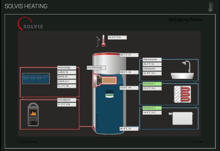

Solvis Heating: < [SOLVED] SOLVIS Heating>
Obviously there’s still much to be done. Camera’s shall be added, attendance record based on wifi-login, email notifications … maybe adding the SmartTV ..
As it seems I’ll be grounded (Corona / Covid-19) for a couple of more weeks so I’m positive for some good progress …

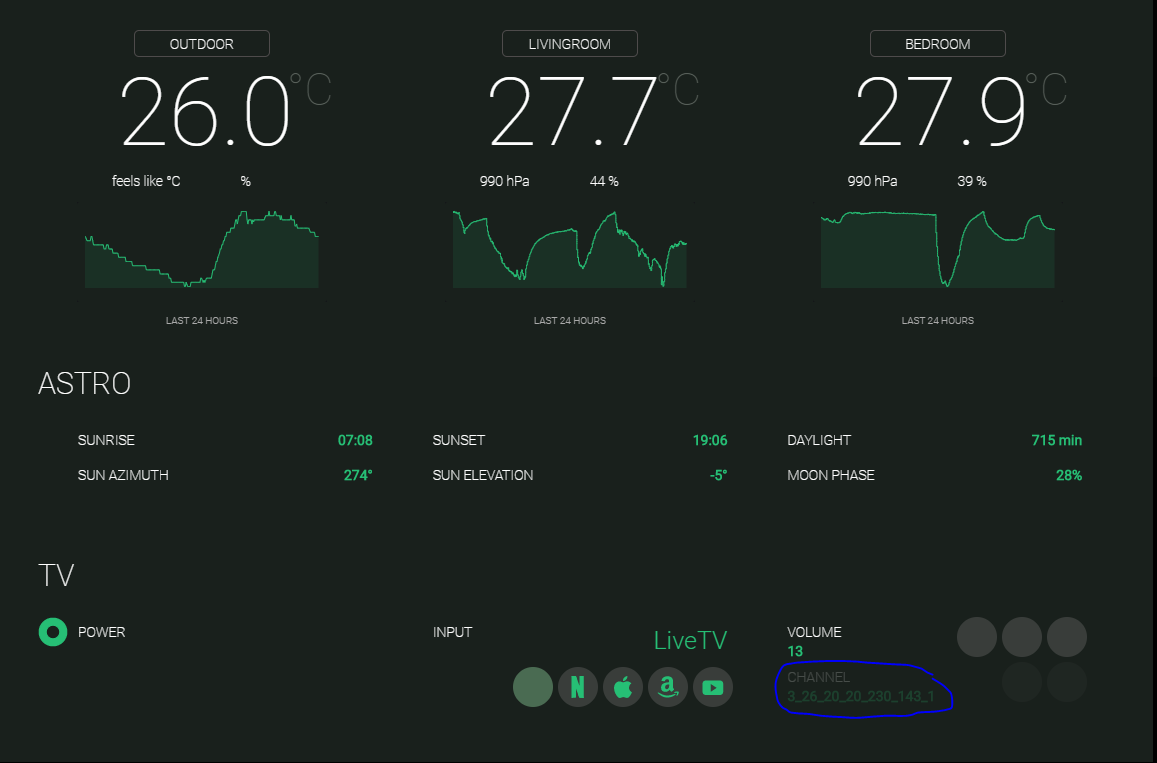

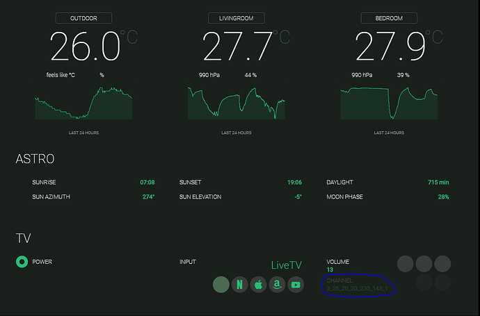

Hey, first off all this theme is awesome. Since I found it two weeks ago I’m working on implementing it to my home. I have a fair knowledge with openhab but I’m not very good with rules, I do use rules but with a lot of trial and error, and I’m a total noob with habpanel custom widgets.
At this moment I’m stuck with the LG TV binding at displaying the curent channel. Here is a screenshot, I don’t have the icons yet.
The problem is that the channel item seems to be a list of all my channels and not the curent channel. The item looks like this in paper ui
This is the item configuration
String LG_TV0_Channel "Channel [%s]" { channel="lgwebos:WebOSTV:tv1:channel" }
And this is the part of the widget code
<div class="name">Channel<div class="value">{{itemValue('LG_TV0_Channel')}}</div></div>
Is there a whey to display what I selected in blue color on the widget and not the full list?
I forgot to mention I use the 2.5.6 LG webOS Binding
Cheers!
