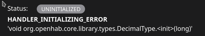

I finally found this extension which, after some struggling with OH, I got almost working. I authorized, the car was found, I entered the VIN and now I’m greeted with:
What can I do to help debug this?
Edit: As text for later reference:
HANDLER_INITIALIZING_ERROR
'void org.openhab.core.library.types.DecimalType.<init>(long)'
I assume you installed binding via marketplace, right?
Unfortunately there are some problems in marketplace evaluating the right binding version. From the error you reported I think the wrong binding version was installed.

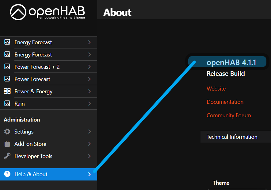

Which version of openHAB do you run?
I’m running openHAB 4.1.1 -Release Build- (looks like your screenshot). The binding says “Updated At

Sadly openHAB Marketplace is mixing up versions. So first cleanup everyting mentioned in post here. (Snippet below)
Afterwards put linked jar in addons folder
