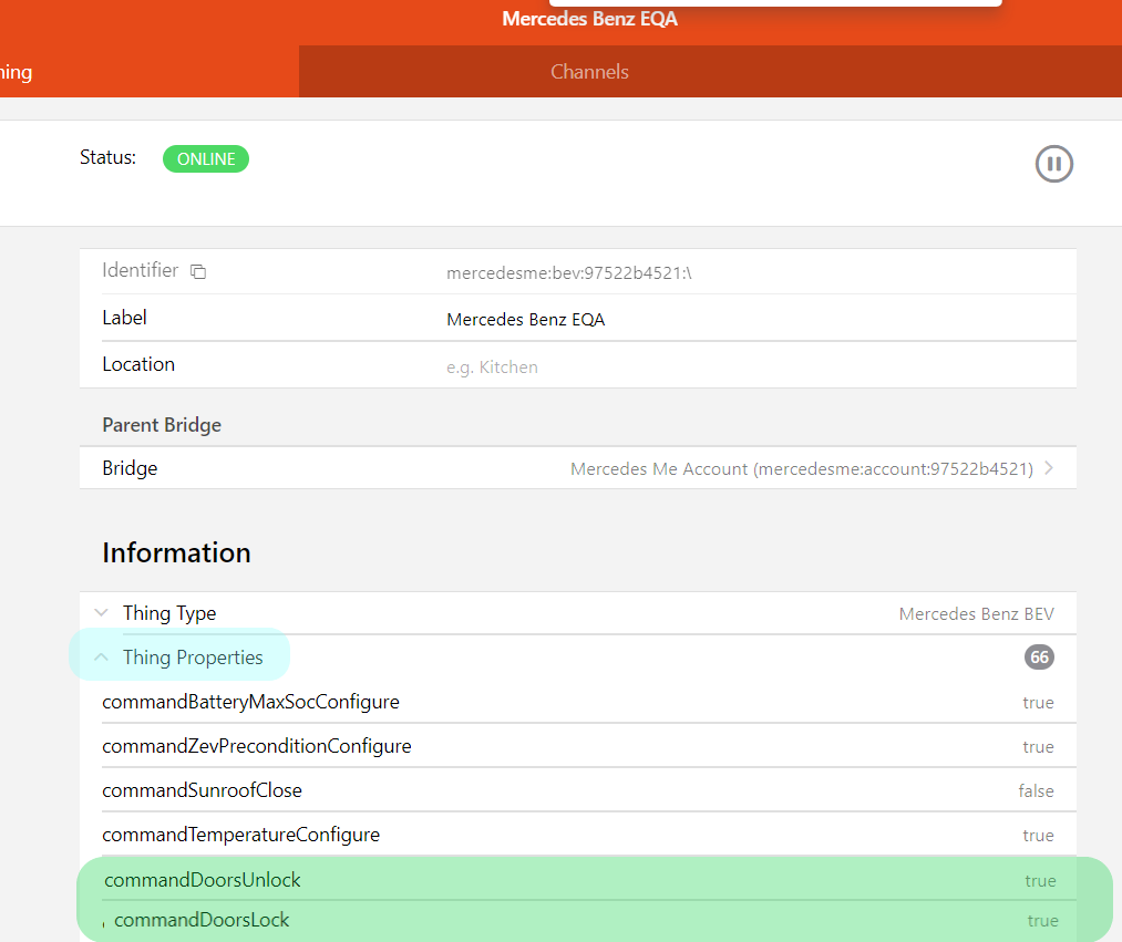

@weymann I managed to get it running after updating my OH to a newer version.
It is correct that it is not possible to lock or unlock the car with this binding right? i only can see the status of the doors but can’t unlock them. Because my idea was to unlock my car automatically if I open my front door between 7 and 8 on a weekday as I go to work
In principle it’s possible
  1. Check if your vehicle is supporting this feature => thing properties (Pic 1)

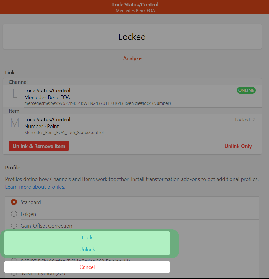

  2. In UI commands lock / unlock are already taken into account (Pic 2)

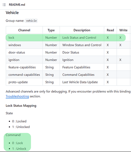

  3. Readme shows lock channel is readable and writable
    Also mapping is mentioned so you can use it in rules.
    lockItem.sendCommand(0) will lock and lockItem.sendCommand(1) will unlock your vehicle
