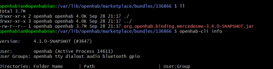

I bundled now a new version. In order to identify the installed version I added short info in proto-update.
	"bindingInfo": {
		"version": "2.2-alpha",
		"vehicle": "mercedesme:bev"
There are still som channel changes so safest is still to
  • destroy old Things
  • uninstall current installed version
  • install newest

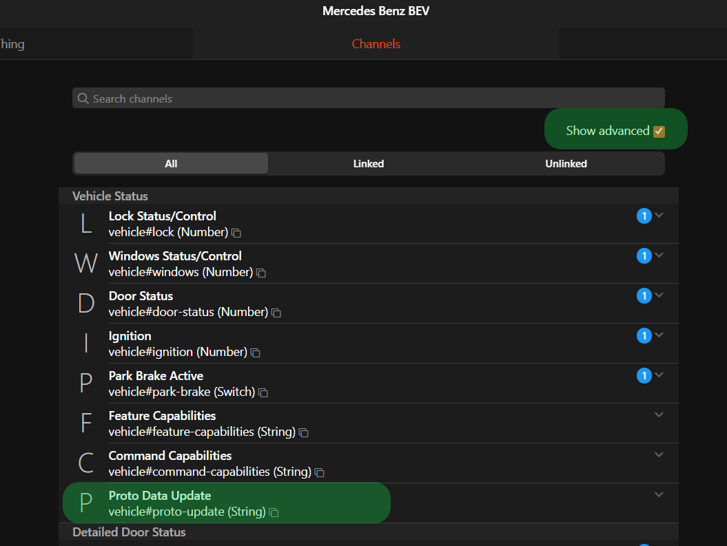

Sending me actual proto-update will help too.

Wht do you mean by proto-update? How to do that?

@phui
proto-update is an advanced channel which shall be used for debugging. It holds the data delivered by Mercedes API.
Nevertheless in this case logs were enough to analyze this problem - negative coordinates caused this issue. Fix is in v2.3-alpha

This looks like something is fundamentally wrong. Saw in previous posts you switched to openHAB Milestone 4.1, right?
I did this too and installed binding from Marketplace. Got the same errors!
Problem is within the Milestone version: Whyever Marketplace took the 3.4 bundle which simply doesn’t fit. Using Marketplace for 3.4 and 4.0 are working correct.
So if you’re running openHAB 4.1M1 you need to downlad the 4.1 smapshot bundle from Mercedes Me and drop it into addons folder
Thanks a lot!!!
Install the new binding and GPS work again !! :slight_smile:

@ulij
All the links to my binding in this forum are referring to the same github repo. There are no hidden version. You will not find anotherone!
The exception you post is too basic - it cannot be explained with the logic of the binding only with conflicting versions.
So I have it running on
  • OH3.4.5 Release Build - Marketplace working
  • OH4.0.3 Release Build - Marketplace working
  • OH 4.1.0M1 Milestone build - Marketplace not working - use addons folder
Which exact openHAB version do you run?
I am on Build #3629.
I was on snapshot and reverted to milestone.
Maybe that’s where it went wrong.
I’ll probably wait for the next milestone.
If you want to use openHAB for daily usage stay on stable versions like OH 4.0.3 where all features are working Snapshots are build daily and every new day there could be a surpise in it.
Nevertheless I switched to latest Snapshot #3647:
  • Doesn’t work with Marketplace - wrong binding installed - same exception as you posted!
  • uninstall Marketplace, drop binding into addons folder - works!
