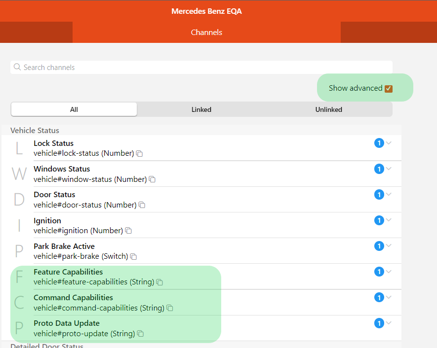

@akashkumar proto-update is an advanced channel. It’s not necessary for this binding functionality but necessary to debug faults. Switch in your vehicle thing to channels and mark the Checkbos Show
advanced (see picture below)
Ok, thanks. Anyway planned to startet a new installation based on OH4. Have the Pi on my desk for 2 month now I guess… Now I have a reason to finally do it.
Thanks @weymann. Somehow, my thing wasn’t showing it at all. I deleted it and added a new thing which indeed shows a lot of channels now, including the ‘Advanced’ option, with the proto channel.

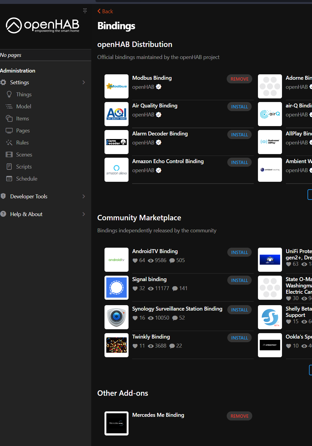

I understand that there might be confusion regarding versions. MercedesMe binding which stopped working end of August is still delivered in the official distribution. Check which version you installed as shown in the below screenshot.
Ensure you don’t installed MercedesMe binding from openHAB Distribution! It is still available in the official distribution and snapshots.
Check if MercedesMe binding is available at Community Marketplace For Snapshot 4.1 I didn’t checked but 3.x and 4.0.x it’s available.
You can check which version is installed via Settings -> Bindings in UI. As you can see in the picture below I dropped the jar into addons folder and the binding is shown in section Other Add-ons
