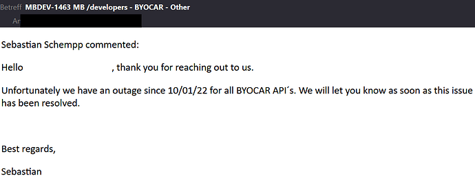

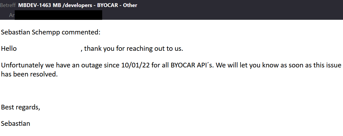

I also thought it’s just a problem in my system, but I see it’s a general problem. If you switch on TRACE level I assume you’ll see Internal Server Error 500 for all API calls.
I raised already an issue ~~ towards https://developer.mercedes-benz.com/contact but I don’t have feedback yet
Feedback:
It takes them weeks to respond, let’s be patient :roll_eyes:
Thanks for the update; and for dealing with Mercedes support. And also thanks to mercedes to come back quickly.
Highly appreciated. Let’s see when they will bring that up again. I’ll turn off trace logging then…
