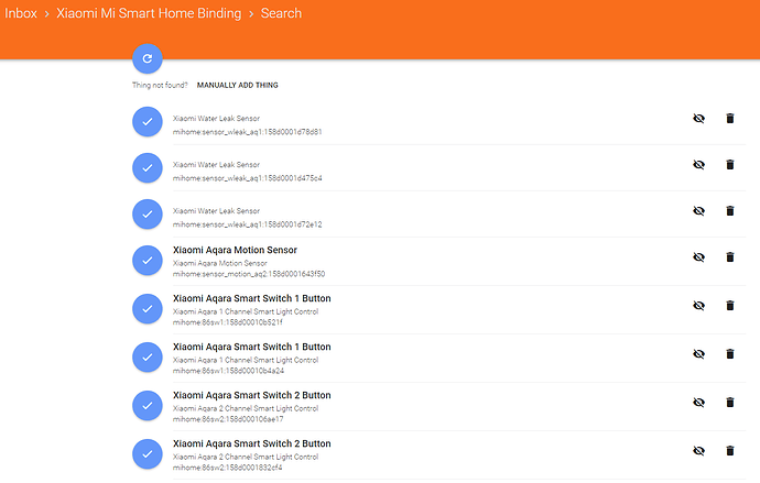

Why are some things highlighted in bold and others not?

The first 3 Things are missing some sort of label. I thought is was something in the binding’s code (https://github.com/openhab/openhab2-addons/tree/master/addons/binding/org.openhab.binding.mihome/ESH-INF/thing), but I see a correct label for all things. I see the same with my water leak sensors.
What has been changed? this code is still working in my setup…
