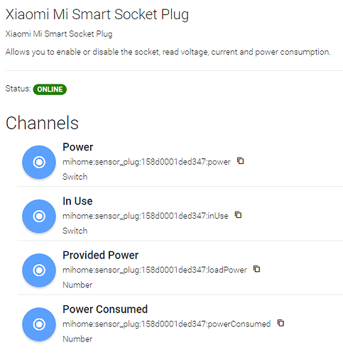

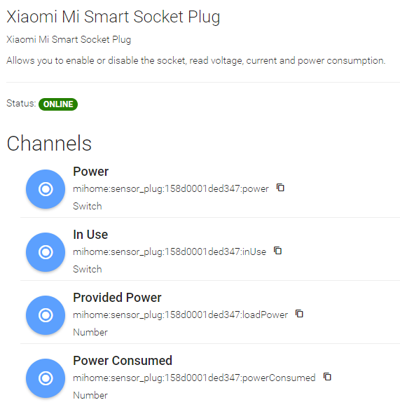

Hi team,
Need your help!
I’ve recently added Xiaomi Zigbee Plug to my collection of Xiaomi devices.

Is there anything that I’ve done wrong in the config?
Items:
Switch 		Mi_Plug_1_Switch 		"Media Centre Switch [%s]"				<switch> 			{ channel="mihome:sensor_plug:158d0001ded347:power" }
Switch 		Mi_Plug_1_Active 		"Media Centre Active [%s]"			   	<switch> 			{ channel="mihome:sensor_plug:158d0001ded347:inUse" }
Number 		Mi_Plug_1_Power 		"Power Load [%.1f W]"					<energy> 			{ channel="mihome:sensor_plug:158d0001ded347:loadPower" }
Number 		Mi_Plug_1_Consumption	"Power Cunsumed [%.1f kWh]"				<line-incline> 		{ channel="mihome:sensor_plug:158d0001ded347:powerConsumed" }
Sitemap:
		Switch item=Mi_Plug_1_Switch
		Switch item=Mi_Plug_1_Active
		Text item=Mi_Plug_1_Power
		Text item=Mi_Plug_1_Consumption
Logs:
2017-10-27 15:58:00.559 [ItemStateChangedEvent     ] - Mi_Plug_1_Power changed from 46.65 to 46.21
2017-10-27 16:11:24.570 [ItemStateChangedEvent     ] - Mi_Plug_1_Consumption changed from 18.536 to 18.563
2017-10-27 16:11:24.571 [ItemStateChangedEvent     ] - Mi_Plug_1_Power changed from 46.21 to 46.65
2017-10-27 16:45:23.496 [ItemStateChangedEvent     ] - Mi_Plug_1_Power changed from 46.65 to 46.21
2017-10-27 16:45:23.497 [ItemStateChangedEvent     ] - Mi_Plug_1_Consumption changed from 18.563 to 18.591
2017-10-27 16:50:44.487 [ItemStateChangedEvent     ] - Mi_Plug_1_Power changed from 46.21 to 46.65
2017-10-27 16:58:27.481 [ItemStateChangedEvent     ] - Mi_Plug_1_Power changed from 46.65 to 46.21
2017-10-27 17:05:46.469 [ItemStateChangedEvent     ] - Mi_Plug_1_Power changed from 46.21 to 46.65
2017-10-27 17:16:21.455 [ItemStateChangedEvent     ] - Mi_Plug_1_Consumption changed from 18.591 to 18.617
2017-10-27 17:17:44.448 [ItemCommandEvent          ] - Item 'Mi_Plug_1_Switch' received command OFF
2017-10-27 17:17:44.458 [ItemStateChangedEvent     ] - Mi_Plug_1_Switch changed from ON to OFF
2017-10-27 17:17:46.100 [ItemCommandEvent          ] - Item 'Mi_Plug_1_Active' received command OFF
2017-10-27 17:17:46.102 [ItemStateChangedEvent     ] - Mi_Plug_1_Active changed from ON to OFF
2017-10-27 17:17:47.575 [ItemCommandEvent          ] - Item 'Mi_Plug_1_Switch' received command ON
Screenshot from Paper UI (I’ve added things via it):
