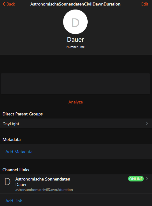

Maybe somebody can help to understand OH 3 behavior of showing states (of items).

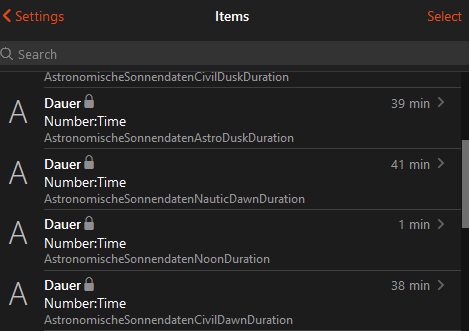

When I go to settings → items, I can see all my items with its status. That’s totally fine.
If I click on an item the current state disappears

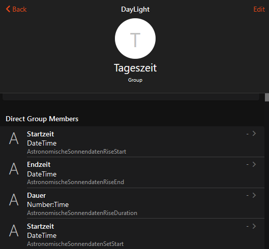

Even my group-items have no state.

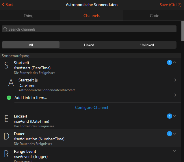

If go to settings → things → channels I cannot see any state
I don’t think it’s normal, isn’t it?
