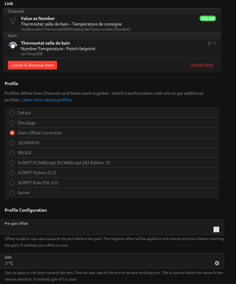

I have just migrated to OH4 and I have a problem with the stepper on my modbus thermostats that I did not have on OH3.
Capture d’écran du 2023-09-23 15-50-19
When I try to change the temperature I get the following error
2023-09-23 15:47:01.136 [WARN ] [nal.profiles.ModbusGainOffsetProfile] - Cannot apply gain ('0.1 °C') and pre-gain-offset ('0') to state ('23') (formula '23'/'0.1 °C' - '0') because types do not match (towardsItem=false): Cannot process command '23', unit should compatible with gain
2023-09-23 15:47:01.296 [WARN ] [nal.profiles.ModbusGainOffsetProfile] - Cannot apply gain ('0.1 °C') and pre-gain-offset ('0') to state ('24') (formula '24'/'0.1 °C' - '0') because types do not match (towardsItem=false): Cannot process command '24', unit should compatible with gain
2023-09-23 15:47:01.424 [WARN ] [nal.profiles.ModbusGainOffsetProfile] - Cannot apply gain ('0.1 °C') and pre-gain-offset ('0') to state ('25') (formula '25'/'0.1 °C' - '0') because types do not match (towardsItem=false): Cannot process command '25', unit should compatible with gain
These are serial-mobus thermostats, I apply a gain of 0.1 °C.
I have the impression that the stepper does not support units
if I change the item type
Number:Temperature → Number
And I change the gain
0.1 °C → 0.1
it works
