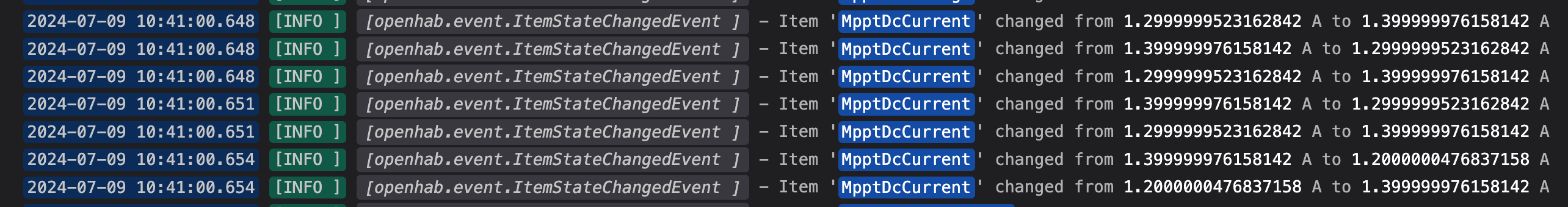

Since this thread has been closed, I would like to reopen the topic as it is a real problem for me as well atm.
I may be able to educate the MQTT server but I am not yet sure I can since it is provided by the Victron Venus OS.
As we can see below and I gettings, even within 1 seconds, many updates.
