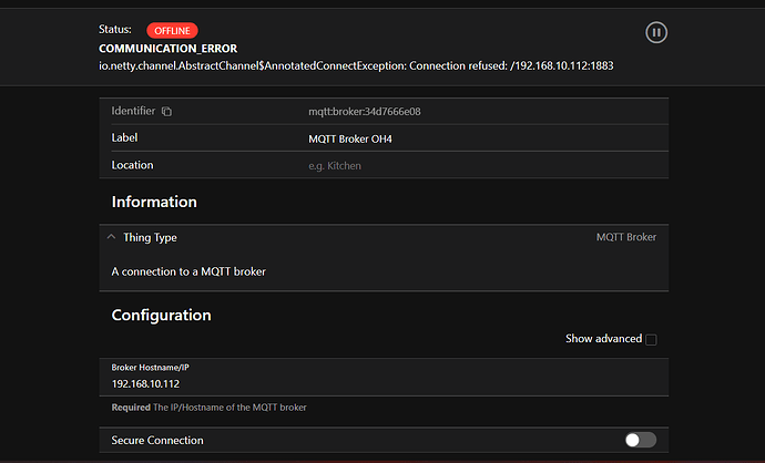

What am I doing wrong ? . I installed the new OH 4.1 and I can’t configure mqtt broker. Previously, I worked on OH 2 and everything worked.

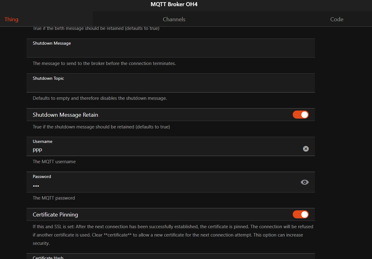

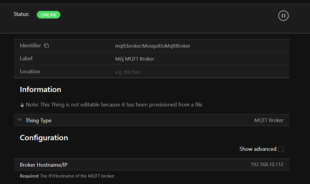

Have you clicked on the show advanced.
There are more settings there.
This is how I set port 1883, user and password
That is the same as I have except I put in a clientid. I made it openhab4 as the name.
I don’t have a username or password set. Other than that it looks the same as what I have.
I am using mosquitto broker as well.
The error you are seeing is connection refused.

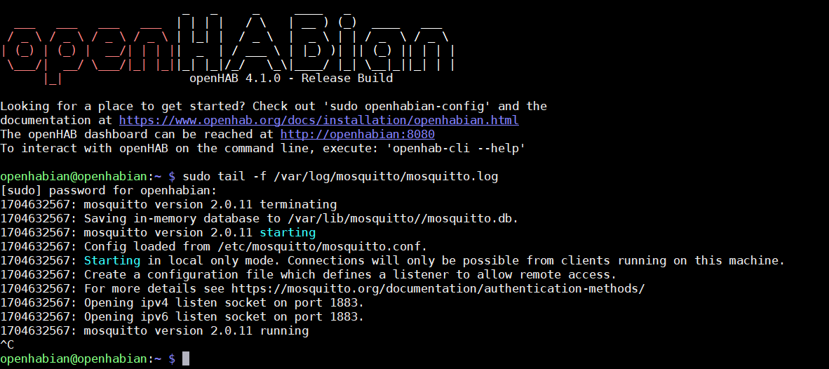

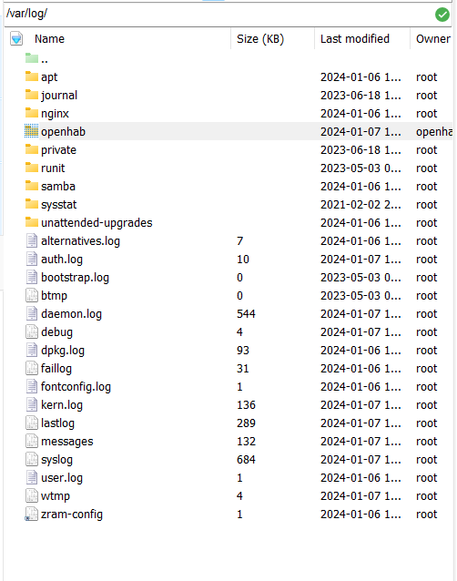

Look at the mosquitto logs.
sudo tail -f /var/log/mosquitto/mosquitto.log

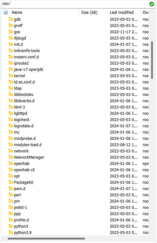

I don’t have such a catalog/VAR/Log/Mosquitto/ x
in /etc/ no mosquitto

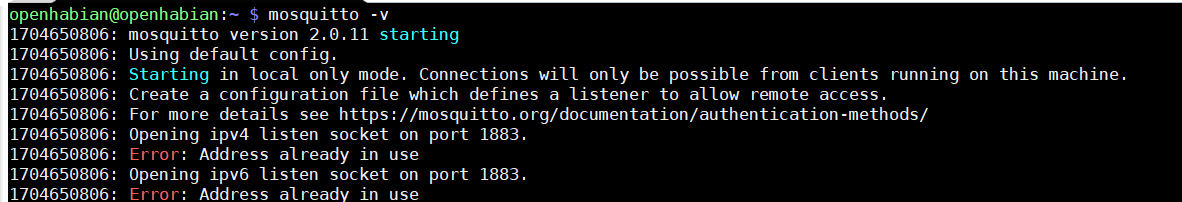

It wasn’t installed, but now it doesn’t seem to want to run.

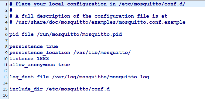

The log is clear, your config is blocking connections from other machines and there seems something is already using that port.

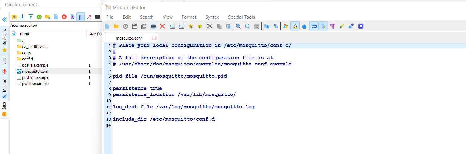

It works, in mosqutto version after 2.0 you need to
mosquitto.conf
listener 1883
add allow_anonymous true
