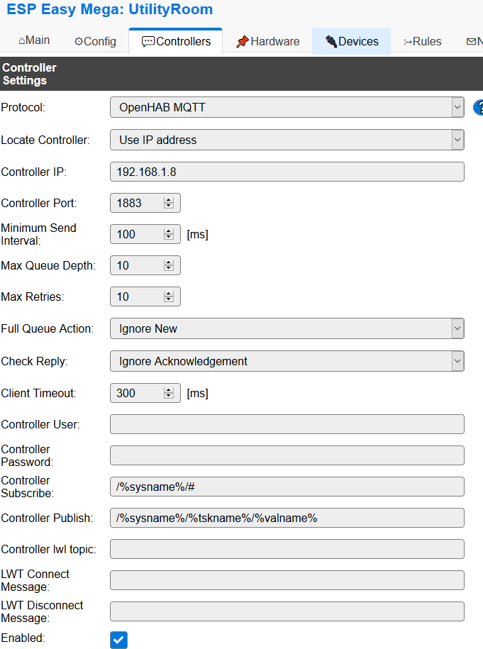

The next challenge was wirelessly controlling the vents. I was becoming somewhat able to do this via my own Arduino coding when I stumbled on a project called “ESPEasy” https://www.letscontrolit.com/wiki/index.php/ESPEasy This project is an easy-to-use firmware that can be loaded onto esp8266 devices and allows for a vast set of devices to be plugged into it as well as a web interface for controlling it all. Hallelujah! I had also found a rudimentary control scheme for openhab by @ben_jones12 : Virtual thermostat - #2 by ben_jones12
It taught me a lot; enough to get my initial setup up and running around February 2017. I created several esp8266+ds18b20 battery powered sensors and placed them in various rooms and used those initially to control the vents in the master bedroom and nursery. I was able to command our Nest on and off and open and close a couple vents to regulate temperatures.
Since those first two servo-controlled vents I’ve expanded control to just about every vent in the house. I’m also no longer using arduinos that need plugged in at each vent. I ran wires back to just a couple central controllers that handle 6 vents each and still run ESPEasy. Commands are sent/received over MQTT. Each room has it’s own virtual thermostat. Some have lightswitches replaced by Nextion displays that allow control over those thermostats as well as the lights. There are a few wall mounted tablets in the house that also allow for manipulation of the room temps.

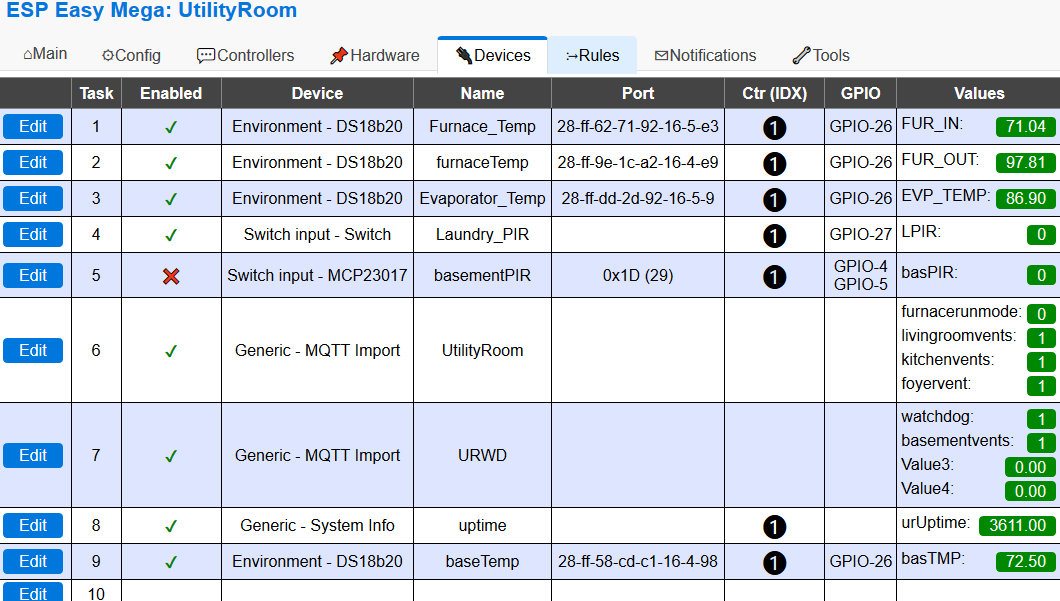

Now instead of fooling with the Nest, I have an 8-relay board mounted in the furnace that takes over control in the evening to heat/cool the bedrooms as needed. I can lock out certain furnace fan speeds and decide based on how many vents are open which fan speeds to use. I have temperature probes located in a few areas of the furnace to be sure temperatures don’t get to low or high and I can select high and low gas valve positions.
All of this has been working reliably for coming up on 2 years now. I continue to improve the code and add “features” to the rules that govern everything. A lot of the rule cleanup credit goes to @rlkoshak and a couple others. Some of the rules are old and haven’t received the same cleanup so the rules are a mix of new/old techniques that I’ve learned.

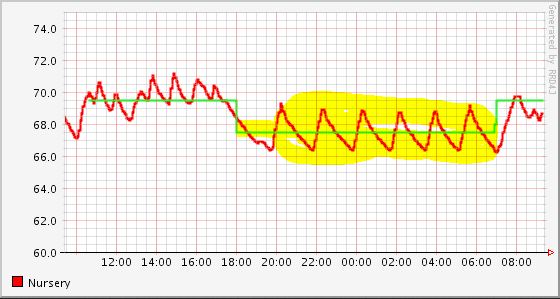

This rule increases the setpoints during the day by 2 degrees:
rule "Upper Rooms Increase/Decrease Day temps"
	Time cron "0 0 7 ? * * *"
	if ( NestTStat_HVAC_Mode.state == "HEAT" )
		gRoomSpPx.members.forEach[t| t.sendCommand(t.state as DecimalType + 2) ]
	if ( NestTStat_HVAC_Mode.state == "COOL" )
		gRoomSpPx.members.forEach[t| t.sendCommand(t.state as DecimalType - 2) ]
This rule resets the setpoints in the evening to resume their night time temperatures:
rule "Rooms Reset Setpoints"
	Time cron "0 0 18 ? * * *"
	gRoomSp.members.forEach[t | t.sendCommand(t.state as QuantityType<Number>)]
Because the setpoints are being sent a command they trigger update proxy rule above so that anything that needs informed of the change will be made aware.

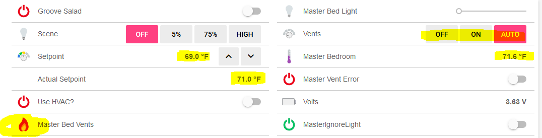

This rule handles the sitemap/phone app/etc simple on/off of the vent:
rule "Vent Mode Control On / Off"
	Member of gVentMode received command 0 or
	Member of gVentMode received command 1
	sendCommand(triggeringItem.name.replace("VentMode","VentTrigger"),if (receivedCommand == 1) "ON" else "OFF")
	if ( triggeringItem.name == "atticVentMode" ) {
		atticVentN.sendCommand(receivedCommand)
		atticAutoN.sendCommand(0)
	if ( triggeringItem.name == "cornerVentMode" ) {
		cornerAutoNXTOut.sendCommand(0)
		cornerVentNXTOut.sendCommand(receivedCommand)
This rule handles opening/closing of the vent based on temperature/setpoint changes. It also makes the call for heating or cooling:

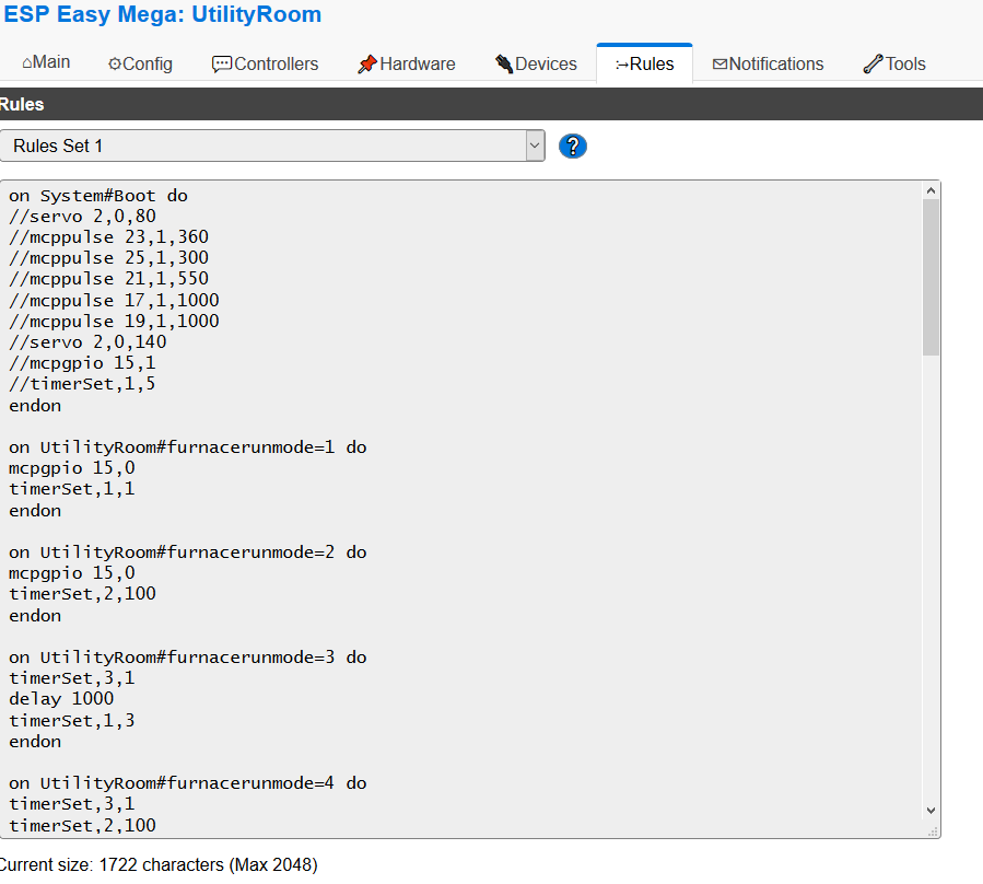

This rule uses the vent triggers to send commands to the esp8266 units and set an error if need be:
rule "Room Vent Actuation"
	Member of gVentTrigger received command
	val baseName = triggeringItem.name.replace("VentTrigger","")

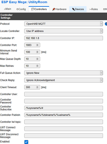

From here I will detail the arduino side of things and the hardware involved. As I mentioned previously, I’m using a firmware for the esp8266 called ESPEasy. Here are some screenshots of what it looks like:
ESPEasy allows for sending/receiving MQTT messages. I take these messages and using the built in rules engine I can switch various things like the dual H bridge or a 16 port mcp23017 channel expander.

Here are some samples of the rules on the ESP:
on UtilityRoom#furnacerunmode=1 do
mcpgpio 15,0
timerSet,1,1
endon
on UtilityRoom#furnacerunmode=2 do
mcpgpio 15,0
timerSet,2,100
endon
on UtilityRoom#furnacerunmode=3 do
timerSet,3,1
delay 1000
timerSet,1,3
endon
The MQTT message is received as “UtilityRoom#furnacerunmode=#”
the mcpgpio turns on or off a channel on the mcp23017 which in turn turns on or off a relay in the furnace. These relays cut out the various fan speeds or connect the heat/cool calls.
The timers allow the furnace to turn on, ignite and stabilize before I change fan speeds or cut the High gas valve. The low valve is energized during High and Low heat calls so I only need to cut High to use Low.
This timer turns all the fan relays to on to cut power to them if the furnace is using them and powers just the low fan speed. Here’s what one of the timers looks like:
on Rules#Timer=2 do
timerSet,1,0
timerSet,3,0
timerSet,6,0
mcpgpio 13,0 //low heat cut
mcpgpio 10,0 //med fan cut
mcpgpio 14,0 //high fan cut
mcpgpio 12,0 //med low fan cut
delay 50
mcpgpio 9,0  //low fan on
endon
The next rule is a vent actuation rule. Power is pulsed to an mcp23017 which switches a leg of one of the L293Ds on to open/close a vent. It also sends an MQTT message back to openHAB to inform it that it has received the command and the vent was actuated:
on UtilityRoom#livingroomvents=1 do
Publish /%sysname%/lrv/ack,1
mcppulse 27,1,2000
mcppulse 25,1,1200
endon

And some pics of the Nextion interface. This is v1. V2 is prettier and laid out better. You get the idea:
Temperature can be adjusted and the vent can be turned on/off, auto, and we can ask for heating/cooling at night using the furnace icon. All these icons are updated via MQTT to ESPEasy if these are switched via openHAB ( sitemap etc).

Here is a simple chart of the nursery temperature. The highlighted portion is the night time when I’m regulating the furnace solely for keeping the nursery up to temp:
