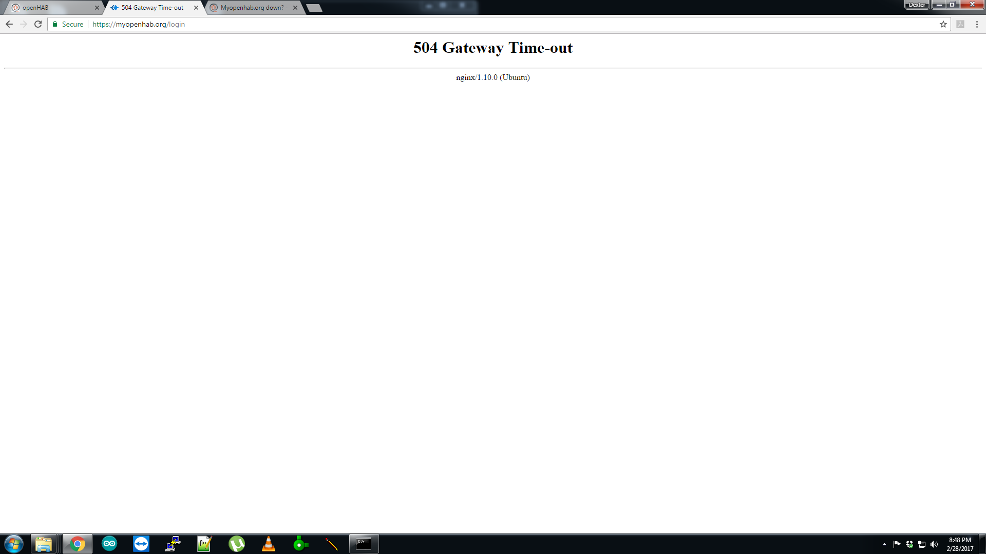

I started receiving push notifications every minute or so that my openHAB instance is offline, but it’s working fine. So I went to login to myopenhab.org, to see if there’s a connection issue, and get a 504 gateway timeout error. Is anyone else experiencing this?
Is there a status page that I can check to see if this a known issue, or a place that it can be reported?
